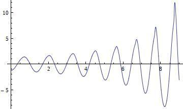

I'm trying to write down the equations of motion for a tetherball moving in 3D around a pole while the string is getting shorter.I've started with lagrange equations:
<br /> x(t)=l(t) \sin (\theta) \cos (\phi)\\<br /> y(t)=l(t) \sin (\theta) \sin (\phi)\\<br /> z(t)=h(t)+l(t) \cos(\theta)\\ \\<br /> <br /> T = \frac{1}{2}m(\dot x^2 +\dot y^2+\dot z^2)\\<br /> U=m g l(t)(1-\cos(\theta)) + mg(S-(h(t)+l(t))) <br />
where l(t) is the length of the string. Here only I am assuming the radius of the pole is really small compared to l. The polar angle is \theta(t). h(t) is the change in height due to the string wrapping on the pole. S is the length of string when unwrapped.
The change in length along is given by:
<br /> \dot l(t) = -\frac{r\dot\phi}{ \sin(\theta)}<br />
where r is the radius of the pole. And the sliding pivot point is given by:
<br /> \dot h(t) = \frac{r\dot\phi}{ \tan(\theta)}<br />
After plugging those in T I apply the Lagrange derivative to L = T-U and solve for \ddot \theta and \ddot \phi
Now when I simulate the results I get a linear velocity that is some how increasing which is not supposed to happen for a tetherball because no new energy has been introduced to the system and the angular momentum is not conserved.
I would appreciate some feedback

I have a small Mathematica script that solves the equations numerically. Another thing that I'm not sure about is how to use the differential equations of l(t) and h(t). Do they come in the Lagrangian as constraints?
But you can see what I did clearly in the script: http://pastebin.com/wUMj0Zyr
If you can run the script you will see the that angle theta keeps growing. Depending on the initial value it could even go over pi/2. Which does not really make sense. Also the energy is increasing over time.

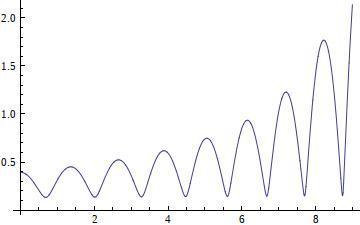

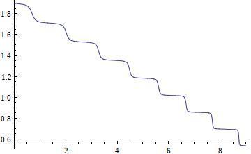

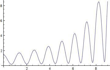

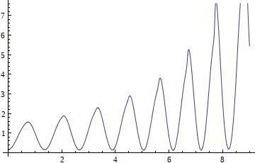

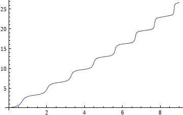

I am uploading plots from Mathematica for a result of simulation. The plots are for [theta, phi, l , T, U, L] respectively. You can see how theta keeps growing and how the energy is also increasing.

I made some progress if you are interested. Instead of plugging the differential equations of l(t) and h(t) I built the extended Lagrangian with the constraints and the multipliers. Now the energy is conserved and the angle theta does not increase randomly.
Here is link to the new mathematica code: http://pastebin.com/MZ2zEpZ7
There still seems to be a a problem that l(t) does not converge to 0 (not wrapped completely). Which is something new.
