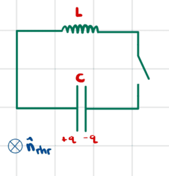

Initially, the capacitor in a series LC circuit is charged. A switch is closed, allowing the capacitor to discharge. After a time ##t_1##, the energy stored in the capacitor is one fourth of its initial value.
Calculate the value of the self-inductance ##L## in terms of ##t_1## and ##C##.
We seem to have the following circuit
and the differential equation ##\ddot{q}+\omega^2q=0## where ##\omega=\frac{1}{\sqrt{LC}}##.

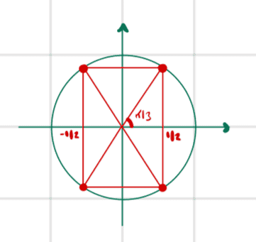

Here is what I did to solve the problem.
The energy in the capacitor at time ##t_1## is
$$U_E(t_1)=\frac{A^2}{2C}\cos^2{(\omega t_1)}=\frac{1}{4}U_E(0)=\frac{A^2}{8C}$$
$$\implies \cos^2{(\omega t_1)}=\frac{1}{4}$$
$$\cos{(\omega t_1)}=\pm\frac{1}{2}$$
This equation is satisfied at four different values of ##\omega t_1\in [0,2\pi)##.
Since ##\omega=\frac{1}{\sqrt{LC}}## is a fixed number, then we have four different times at which the energy in the capacitor is a fourth of the initial (maximal) value.
Let's consider one of four instances.
$$\omega t_1=\frac{\pi}{3}$$
and after subbing in for ##\omega## and solving for ##L## we get
$$L=\frac{9t_1^2}{C\pi^2}$$
