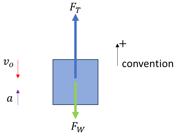

Booster rockets can be reused if they land safely. One way to slow a booster for landing is by firing its engine again. Now, thrust pushes opposite the direction the booster is moving. This technique is called propulsive landing.
Determine the thrust needed to propulsively land the booster described below.
A 25,000kg booster rocket is falling. It experiences a gravitational pull of 245,000N.
The booster's engine fires for 13 seconds before landing, slowing the booster from a velocity of
172 m/s to 0 m/s over that time.
a=v-u/(t)
a=Fnet/m
a=v-u/(t)
a=0-172/(13)
a=approx -13m/s^2
a=Fnet/m
-13=Fnet/25000
Fnet=-13(25000)
Fnet=-3250000N
Fg+Fth=-325000N
Fth=-325000-245000
Fth=-670000N
Any hints as to where have I gone wrong?

Make a diagram if you are having trouble. Define up or down to be positive, draw vectors for the velocity, acceleration, and forces. Proceed to write equations that are consistent with the convention you chose. Then, when you are done doing that, choose the other direction as positive convention and redo the equations w.r.t. the new convention. You will get the same result if you have been consistent and there will not be a need for "absolute value".
Thanks. I’ll start with up as positive direction.
I imagine at some point after launch, during the ascent, the v was 172m/s in the positive direction, or 172m/s upwards.
They, when referring to the descent, give the v as 172m/s, with downwards implied, so they’re assuming downwards as the positive direction, I think. But I’m starting with up as positive so their v becomes -172m/s.
a=v-u(t)
a=-172/13
a=-13.2
A negative a makes sense, I think, with up as the positive direction.
Now Newton’s second law.
They, when referring to Fg give 245,000N, a positive value, again assuming downwards as the positive direction. Which for me, starting with up as positive, becomes -245,000.
a=Fnet/m
-13.2=Fnet/25,000
Fnet=-13.2(25,000)
Fnet=-330,000
Fg+Fth=-330,000
-245,000+Fth=-330,000
Add 245,000 to both sides
Fth=-330,000+245,000
Fth=-85,000
Why have I ended up with a negative? If I’m assuming up as positive Fth should be positive, yeah? And I know I’m looking for a answer with magnitude 575,000.
I’ll now assume downwards to be the positive direction.
a=v-u/(t)
a=172/13
a=13.2
a=Fnet/m
13.2=Fnet/25000
Fnet=13.2(25,000)
Fnet=330,000
Fg+Fth=330,000
Fth=330,000-245,000
Fth=85,000N
Which, again, is incorrect. I'm looking for a magnitude of 575,000. And both answers should be the same in terms of positive/negative.
It doesn’t. To slow a downward velocity you need an upward acceleration.
kuruman said:
When you write Fg+Fth=Fnet and think of these as magnitudes of vectors, there should be a relative negative sign on the left because the forces are in opposite directions.
Thanks.
Do you mean i should write it like this:
-Fg+Fth=Fnet?

paulb203 said:
Thanks.
-Fg+Fth=Fnet?
If up is positive, yeah.
So given that the acceleration is positive here, we will find that the force of thrust is larger than the rockets force of weight.

paulb203 said:
Thanks. Is the v for velocity? What about the o next to it?
That's initial velocity. the "o" subscript is what you will see to indicate an initial state. ##v_f## would be final velocity.
paulb203 said:
Upward = positive direction;
a=(v-u)/t
a=(0 minus -172)/t
Don't write out "minus".
$$ a = \frac{v-u}{t} = \frac{0 \frac{ \text{m}}{ \text{s}} -(-172 \frac{ \text{m}}{ \text{s}}) }{13\text{s}} = \frac{172}{13} \frac{ \text{m}}{ {\text{s}}^2} $$
paulb203 said:
Fg+Fth=330,000
It the confusion starts right here. we are dealing with signed scalars ( not vectors ) so,
$$F_{th} - F_g = 330,000 \frac{ \text{kg~m}}{ {\text{s}}^2} $$
paulb203 said:
-245,000+Fth=330,000
The value is substituted correctly, but it's not clear you understand that based on your next result.
paulb203 said:
(now the acceleration is negative, but it’s still upwards acceleration, given the context, to slow the booster down)
Fg+Fth=-330,000
Again, same mistake you consitently are making - you have the force of weight and thrust both positive?
One of them is negative in this convention, which one?
Yes, signed scalars, and ##F_g## is negative. ##F_{th} + F_g = 330,000 \frac{ \text{kg~m}}{ {\text{s}}^2} ## is correct.
##F_g## is a positive scalar, and "minus" is its sign?
If something is speeding up in kinematics how often do you write ## v = u - at ## where ##a < 0##? If signed scalar it is not accurate choice in the name, it's surely the case in practice that ##a > 0##.
If you want to teach signed scalars by definition instead of how they are used in this context and prolong this, be my guest. I'll stand aside.
paulb203 said:
Thanks.
-Fg+Fth=Fnet?
Yes. This is consistent with the convention up is positive and down is negative.
If you choose the convention down is positive and up is negative, you would write
Fg - Fth = -Fnet
Note that you get the second equation if you multiply both sides of the first equation by -1 but the relative sign on the left is still negative.
Sorry, why is ##F_g## positive? g is always taken to be a positive constant, but ##F_g## can be signed, being mg if down is positive or -mg if up is positive.
If you insist on its being positive then you are declaring it a magnitude, not a signed scalar.
Many write ## v = u - at ## in that case because they are more comfortable with magnitudes. If the intent is to work in signed scalars then the same direction should be positive for ##u, v, a##, and the equation should be ## v = u + at ##.
The OP seems to have done this correctly in this instance.
I see no indication that @paulb203 is thinking of them as magnitudes. Rather, the treatment appears to be consistently as scalars (preferable, to me).
-Fg+Fth=Fnet?
No. You are quite entitled to work with scalars rather than magnitudes. Sometimes it is not at first clear which way a force will act, making scalars the natural choice.
If g is a positive constant, it was never clear to me why other variables should be treated differently because I feel like it obscures intent.
Anyhow, I think I’d just prefer they teach vectors at the point of using “signed scalers”. It seems to me I have trouble differentiating whether or not people are intending to use magnitudes or a signed scaler in equations that has already had the signs absorbed into the algebra.
But anyhow I know what you mean, and I think you know what I mean. If I didn’t see what the OP means in the 3 attempts I don’t think it hurts my case. Let’s work with vectors or let’s work with magnitudes in my opinion. I don’t think I see the utility of somewhere in the middle, and certainly have found it confusing.
Ambiguity and confusion can be avoided if one uses unit vector notation as an intermediate step and then remove them.
Assuming down as negative and up as positive
##\mathbf F_{\text{th.}}+\mathbf F_{\text{g}}=M\dfrac{\Delta \mathbf{v}}{\Delta t}.##
## F_{\text{th.}}~(\mathbf{\hat{y}})+(245,000~\text{N})~(-\mathbf{\hat{y}})=(25,000~\text{kg})\dfrac{0-(172~\text{m/s})(-\mathbf{\hat{y}}) }{(13~\text{s})}.##
## F_{\text{th.}}-(245,000~\text{N})=(25,000~\text{kg})\dfrac{(172~\text{m/s}) }{(13~\text{s})}.##
## F_{\text{th.}}=(245,000~\text{N})+(25,000~\text{kg})\dfrac{(172~\text{m/s}) }{(13~\text{s})}.##
Assuming up as negative and down as positive
## F_{\text{th.}}~(-\mathbf{\hat{y}})+(245,000~\text{N})~(\mathbf{\hat{y}})=(25,000~\text{kg})\dfrac{0-(172~\text{m/s})(\mathbf{\hat{y}}) }{(13~\text{s})}.##
## -F_{\text{th.}}+(245,000~\text{N})=-(25,000~\text{kg})\dfrac{(172~\text{m/s}) }{(13~\text{s})}.##
@haruspex and I have been over this with 1d vectors several times in the past and (I think) we have agreed to disagree. When all vector directions are known, as is the case here, I favor expressing vectors in polar form, i.e. separate the magnitude, which is always positive, from the direction which can be positive or negative. Splitting the two is easier to explain to novices who are taught that vectors have magnitude (always positive) and direction. The danger here is that some students use false logic: magnitudes are always positive, a vector is a scalar times a direction, therefore a scalar is always positive.
If both the direction and magnitude of a vector are not known, then one can assume a direction and do the algebra to find the magnitude. If the magnitude turns out to be negative, then one must conclude that the direction is in the opposite direction of the one assumed. The idea is no different from what is taught as standard practice when using Kirchhoff's laws to analyze circuits: "Assume a direction for the current and if the current turns out negative, this means that it flows in the opposite direction."
