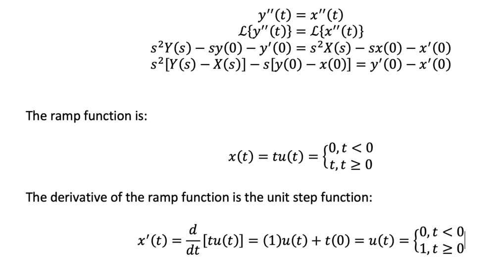

Suppose I'm solving
$$y''(t) = x''(t)$$ where $$x(t)$$ is the ramp function. Then, by taking the Laplace transform of both sides, I need to know $x'(0)$ which is discontinuous. What is the appropriate technique to use here?
Check the screenshot I attached:
Typeset math: Laplace transform of y''(t) = x''(t) giving s^2 Y(s) - sy(0) - y'(0) = s^2 X(s) - sx(0) - x'(0), rearranged to s^2[Y(s) - X(s)] - s[y(0) - x(0)] = y'(0) - x'(0); below, x(t) = tu(t) is a ramp, and x'(t) = u(t) is the unit step.

How is your course defining the Laplace transform? There is more than one way, especially with regards to how you treat the origin and singularities/discontinuities at the origin such as the one you are dealing with. By the way, the right-hand side of your problem is a delta functino: ##x^{\prime\prime}(t) = \delta(t)##.
