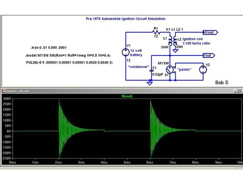

Ignition spark timing is good to better than ≈ 100 microseconds with the old pre-1970 circuits, and probably 5 x better using transistorized CD (capacitor discharge) circuits. A more efficient way is to heat the fuel itself using adiabatic compression (diesel engine).
Bob S
