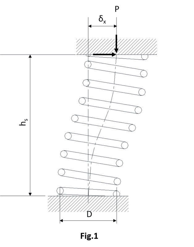

Hi,
Is there a simple formula to calculate the lateral stiffness of a compression spring when both ends stay in parallel (see figure)?
244775
Get a copy of the SMI Fundamentals of Spring Design, or an older edition titled Handbook of Spring Design. It has a plot showing exactly what you need. Buy a copy for only $25.00: https://smihq.org/store/ViewProduct.aspx?id=8088348.

Thanks. I will take a look at it.
There is another dynamic typically not apparent. The spring tries to twist and rotate on both ends when compressed. These things work even if only used on one end. They can tilt and they have a row of needle bearings to permit rotation and no binding.

As far as I can tell from my limited research, coil springs will rotate while being compressed in the vertical direction. I know this from experience over decades of auto racing. This rotation or twist is known as "indexing".
The usual method is to mechanical fix one end of the spring if it becomes a major problem. The deeper you ding into this you find it is not "indexing" it is called "Ratcheting" and lots of things effect it. Are both ends of the spring parallel ground and flat? Is one end fixed? Is the free end riding on bearings?
I have found three solutions to find out how much the spring ratchets.
Hot rodder method - Take a random sampling of 10 springs and mark one of the coil's OD. Then compress the spring and measure how far around the coil it travels. My question is “Why Bother”. In racing ideally you want the spring to compress without any side thrust and minimum of friction at the spring ends when compressing. That’s why we use hydraulic spring perches and worry about other handing aspects. Look carefully at the video of the hyperco perch above. You can see the coil spring twist during compression. Look just below the E and note the white spot moving side to side. It looks like 1/8" but you can see it move laterally.
Solve for Unwinding Method - Spring Design by Wahl as reference to rotation during compression and gives the formula. The angular deflection (unwinding) of the ends for compression spring due to axial loading is given in page 249 of Mechanical Springs, A. M. Wahl 2nd Edition 1963. Therefore, the maximum torque will be the torque to prevent it. For this you need to treat the spring as a torsion spring and calculate the torque that will create/negate this deflection. However, the axial force, coefficient of friction and spring diameter create a moment that may be smaller than the maximum moment.

For precision spring function applications such as high performance pressure relief safety valves there are spring washers with a ball and socket center pivots installed on both ends of the spring to minimize resistance to the above discussed end rotation.
This book is THE reference for springs. If it's not in this book, you will not find it anywhere. And it's still in print. If the SMI book does not answer your questions, get this book.
