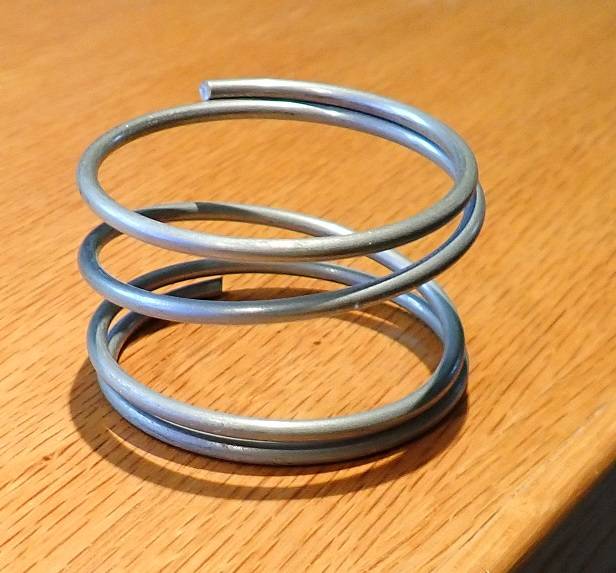

A coil spring can be made by winding wire on a mandrel. The wire is bent far enough that it plastically deforms, and then stays bent, although with some springback. The spring in the photo below was made that way:
This particular spring was my first attempt at making a replacement spring for a mechanical seal in a trash pump. High speed production spring making machines use a slightly different method, but the results are the same. Straight wire is bent into the spring shape. Small springs are bent cold, while very large springs may be made by hot bending and heat treating.
The primary stress state from using a helical spring in its elastic range is torsion. The best source to learn about spring design and stresses is the SMI Handbook of Spring Design: https://smihq.org/store/viewproduct.aspx?id=8525988. This book is 100 pages of spring goodness, and is highly readable. Strongly recommended.
And it you REALLY want to understand stresses and energy storage in springs, the book is Mechanical Springs by A.M. Wahl: https://smihq.org/store/viewproduct.aspx?id=8088306. This book is not available from Amazon.
