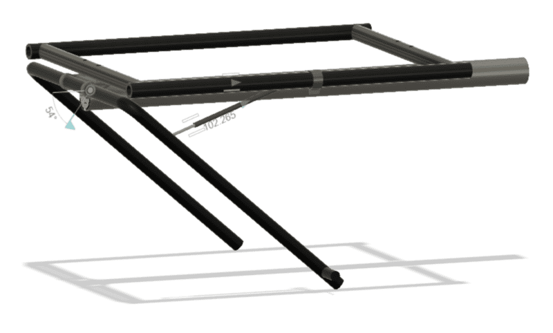

I also attached 3 pictures with a visualization of the kickstand attached to the rack of the bike, and with a gas spring holding on to both components.
CAD rendering of a black-and-grey tubular frame with a thin rod linkage, resembling a bicycle rack or kickstand mechanism, with a gas spring shown as a thin rod attached to the frame.
CAD model of a folding bicycle kickstand frame: a black tubular rectangular top bar with two angled legs meeting at a pivot joint, with an angle label of 54 degrees and a gas spring dimension of 102.265 mm.
CAD render of a black tubular rectangular frame with one end of the bar grey, a dimension label reading 143.000, and an angle marked 83 degrees at the lower left.

I would avoid a gas spring on a bicycle.
They are insufficiently reliable and need a clean environment.

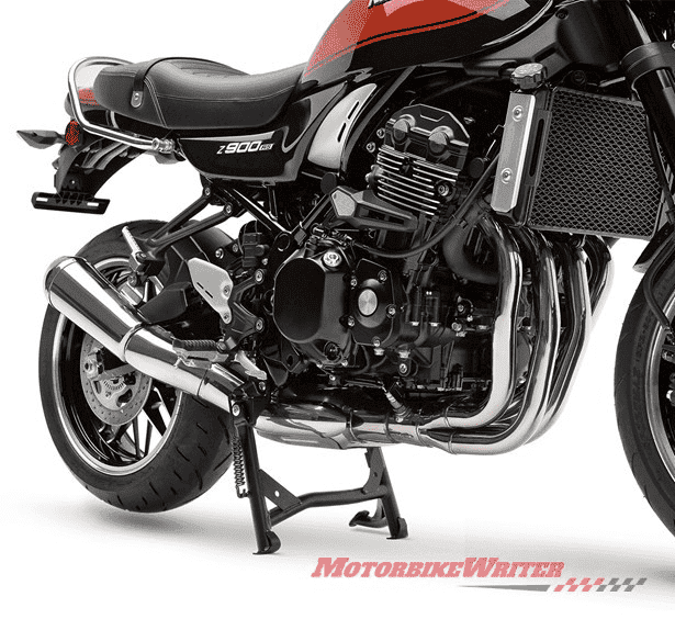

Have you looked at traditional center stands for motorcycles? They have a couple design features that make them easy to use, even with heavy motorcycles...

The kickstand for the motorbike is a good starting point, and I will for sure use the mechanisms from it.

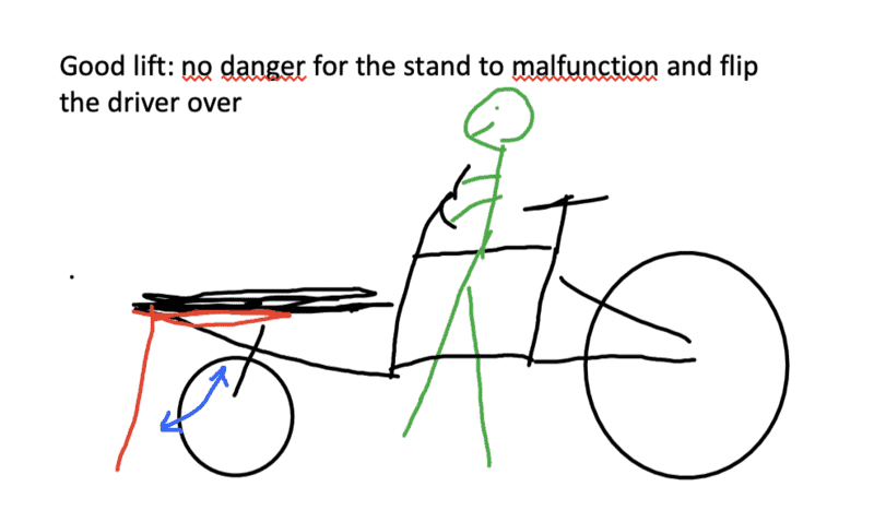

The stand must lift up to the rear. That way it cannot drop while you are traveling forwards. Lower the stand, then push the bike backwards with your feet to lock the stand. To raise the stand, push the bike forwards. It requires some way to;
1. release the stand to drop down when parking.
2. lift the stand when starting riding.
3. latching the stand in the up position while travelling.
I would look for one control lever only. First move would open the latch and drop the stand, so pushing back will then lift the bike onto the stand. Further movement would swing a link onto the surface of the front wheel that would lift the stand to the catch.

I think the angle joint of the kickstand should be in the front, so in a situation where the kickstand would break or malfunction, It won't risk the rider being thrown off the bike. this is the issue I'm talking about:
Hand-drawn sketch of a bicycle with a kickstand, with a green stick figure rider, a red kickstand arm and a blue arrow at the stand, captioned "Good lift: no danger for the stand to malfunction and flip the driver over".
Hand-drawn sketch of a bicycle with a stick-figure rider, with a red kickstand and a blue arc at the rear wheel. Caption reads: Bad lift: danger for the stand to malfunction and flip the driver over.

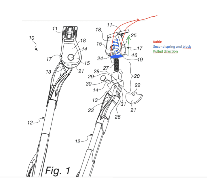

I've thought about a mechanism that could:
1. remove the tension of a spring and therefore allow the kickstand to go down into the "stand" position and lock it where it's stable. This could be performed by a level, a gear/brake cable and another spring and a small metal block with the cable endings attached to it.
2. When the level is not pressed the spring would keep its normal tension, and press the feet of the kickstand back to its uprise.
I hope this dirty sketch makes a little sense:
Patent-style line drawing, Fig. 1, of a bicycle kickstand mechanism with reference numerals; a red cable path, blue second spring and block, and green pulled-direction arrows are added by hand.
I would look for a way that does not involve heavy work being done through a lever and cable.
I would remove big springs from the design and use positive latches.
I would raise the stand by moving the bicycle and using rotation of the front wheel to do the work.
