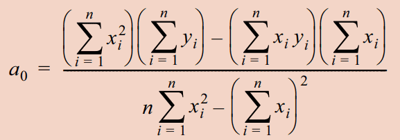

Given a set of data points, we aim to fit a line to these points by minimizing the total error and finding the coefficients ##a_0##(intercept) and ##a_1##(slope).
Each of these data points has an associated error. Derive the expressions that give the errors (uncertainties) of ##a_0## and ##a_1##.
I'll mention the relevant equations later in my solution.
We are given a set of points ##(x_i , y_i)##. If we want to fit a line to these points which has the form of ##y=a_0+a_1x##, we need to do it in a way which minimizes the total error E:$$E = \sum_{i=1}^n (y_i - a_0 - a_1x_i)^2$$So we set ##\frac{\partial E}{\partial a_0} = 0## and ##\frac{\partial E}{\partial a_1} = 0## and solve the system of equations. Then we get:
My problem , I have no idea how to start with errors to find uncertainties of ##a_0## and ##a_1##.
I believe you need to make some assumptions on the residuales; IIRC, normality and homostadicity, in order to find the distribution of the slope, intercept. Under " reasonable" conditions, they are both normal and converge to the true value.
