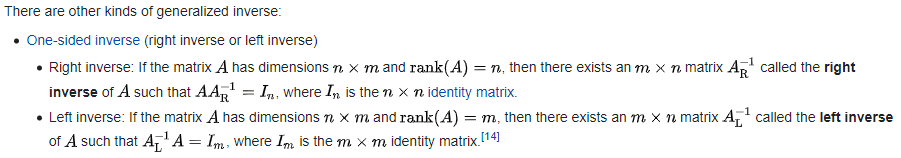

I was working with right inverse and left inverse of a matrix.
Please check my work below.
Hi,
It's actually not a homework problem but I still decided to post it here.
Problem:
Consider Ax=y, where A is mxn and has rank m. Is (A′A)⁻¹A′y a solution? If not, under what condition will it be a solution? Is A′(AA′)⁻¹y a solution?
The given solution is:
Consider Ax=y with A mxn and rank(A)=m, which implies n⋝m. If n>m then A′A is nxn and singular . Thus (A′A)⁻¹ is not defined and (A′A)⁻¹A′y is not a solution. Because AA′ is mxm and nonsingular, substituting A′(AA′)⁻¹y into Ax yields y. Thus A′(AA′)⁻¹y is a solution. If n=m then both reduce to A⁻¹y and are solutions of Ax=y.
Question 1:
A′(AA′)⁻¹ is right inverse but the system in question statement is written as "Ax=y". The yellow highlighted text below says that a right inverse, A′(AA′)⁻¹, is useful for solving XA=Y system. You notice the contradiction. Which source is correct? Given solution or the yellow highlighted text? Could you please help me?
Source: https://math.stackexchange.com/a/1335707/775285
Question 2:
Mostly it's written AX=B where B is a constant matrix. In the case above the system is written instead as Ax=y. Is B=y? This link is relevant here . Could you please help me with it?

I cannot interpret this:
If they mean premultiplying by A′(AA′)⁻¹ it yields A′(AA′)⁻¹Ax=A′(AA′)⁻¹y. If A were non singular we could expand that inverse and get x=A′(AA′)⁻¹y, but not otherwise.
The veracity of the statement in yellow is easily checked.
For q2, the usual is to use uppercase for a matrix and lowercase for a vector, but of course the latter is just a special case of the former.

Note to self:
Source: https://en.wikipedia.org/wiki/Generalized_inverse
these formulas you give for left and right inverses work over ##\mathbb R## but do not work over other fields -- so the thread is a bit misleading; I assume we are working over ##\mathbb R## from here forward. I also wouldn't read too much into the stackexchange linked post.
If ##A## is surjective and you are trying to solve for an ##\mathbf x## such that ##A\mathbf x = \mathbf b## then you know a solution exists (by surjectivity) and so you actually want to use the right inverse formula. The 'left inverse formula' actually corresponds to the case of ##A## being injective, so if a solution exists, it will be unique and you will find it, but a solution may not exist-- in such a case you actually have ##A\mathbf x\neq \mathbf b## for all ##\mathbf x##, and working over ##\mathbb R## you cannot 'solve' such an equation but you can find a unique candidate ##\mathbf x## that minimizes ##\Big \Vert A\mathbf x- \mathbf b\Big \Vert_2##

Suppose ##A\in \mathbb R^{m\times n}## is surjective and you want to find some ##\mathbf x## such that ##A\mathbf x = \mathbf b##, where of course ##A## and ##\mathbf b## are specified beforehand.
Then one valid solution is ##\mathbf x := (AA^T)^{-1}\mathbf b## because ##(AA^T)^{-1}## is a right inverse so
##A(AA^T)^{-1}= I_m## (which is the definition of a right inverse)
##\implies A\mathbf x = A\big((AA^T)^{-1}\mathbf b\big)= \big(A(AA^T)^{-1}\big)\mathbf b = I_m \mathbf b=\mathbf b##
it turns out in reals this is the minimum length (2 norm) solution for ##\mathbf x## that satisfies ##A\mathbf x = \mathbf b##. But based on the level of questioning I think this is way out side the scope.
PainterGuy said:
Why is the original system written as AX=Y and not as AX=B? Could you please guide me?
I mentioned before that a common convention is to use uppercase for matrices and lowercase for vectors. Another is to use A, B.. for matrices and X, Y.. for vectors; but, confusingly, also using X for an unknown matrix. So in AX=B suggests matrices whereas in AX=Y X and Y may well be vectors.
But these are only conventions. In any given usage the meanings should be made clear by the context,
Thank you very much!
I understand it now that why the right inverse was written on the left for the given case.
