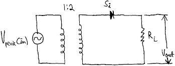

My professor gave us a formula for the left-over output AC voltage in a half-wave rectifier. This formula was given without any calculus or explanation as to how it was obtained.
[tex]V_{out(AC)}\simeq (0.385)(V_m-V_{th})[/tex]
I don't know if Vm is the peak input voltage or the peak secondary voltage (see image below). I do know that Vth is the threshold voltage of a diode; 0.7V for Silicon and 0.3V for Germanium.
Circuit schematic of a half-wave rectifier: an AC source Vpeak(in) feeds a transformer with turns ratio 1:2, the secondary drives diode S1 into a load resistor RL, with output voltage Vout taken across RL.
Does anybody know how this formula was obtained? I don't have any information in my textbook on it and I've read the chapters twice.
Vm is most likely the secondary voltage that's being rectified. If I had to guess, I'd suggest that the formula would come from some tinkering with the Fourier series of the rectified signal. One can pull out the DC component and the various AC harmonics...
Thank you gneill. Next time I see the professor I'll ask him about this.
FYI, curiosity overcame me this morning so I took the Fourier series of an ideal half-rectified sinewave and extracted the total RMS AC component of the signal. I found an exact expression for the constant:
##\frac{\sqrt{\pi^2 - 4}}{2 \pi} ≈ 0.385589...##
So if a transformer were to be involved, this RMS AC voltage would be based on the *secondary* peak voltage, not the primary peak voltage, right?
My professor didn't say whether the AC was peak or RMS but you have clarified that. Thank you. I'm going to have a discussion about the lack of specificity in this class.
Yes, it has to be the secondary peak voltage since the formula subtracts the diode drop which occurs in the secondary circuit.
Good luck with that :smile: :smile: :smile:
Back from class. The teacher let me grab the chalk and draw a tranformer hooked up to a rectifier circuit. I explained my confusion and he confirmed that his formula relates to the secondary peak voltage. I've gotten more help from Physics Forums than my expensive college courses. Thanks yet again.
