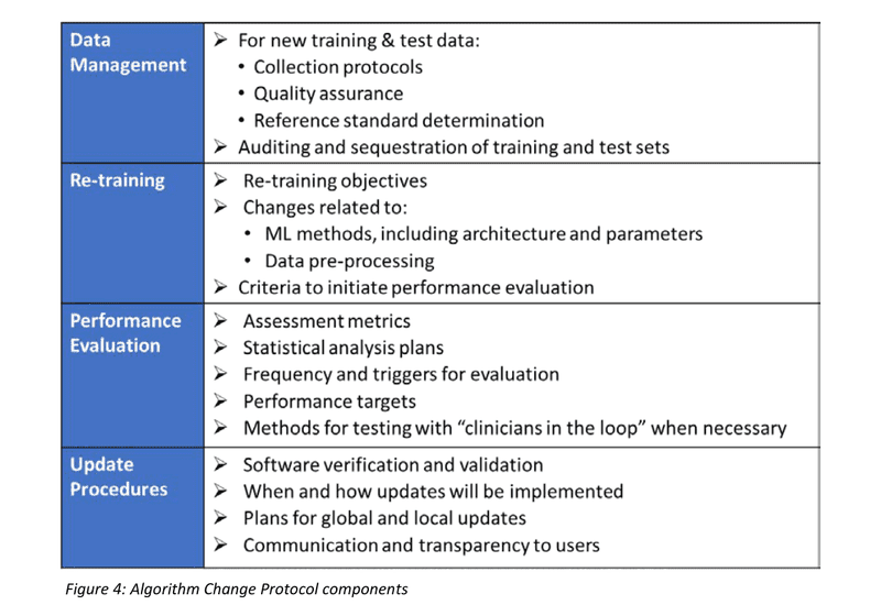

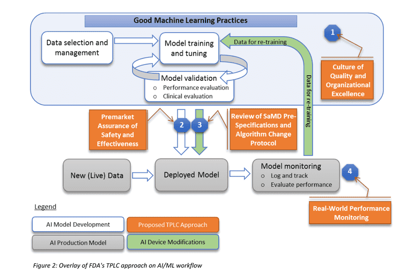

  • #86
I would add that I disagree with you about the case for the biomedical products. Although I can't say that I know what new different standards for regulation have already been implemented and how much is future work. This article does a good job explaining.
The FDA’s traditional paradigm of medical device regulation was not designed for adaptive artificial intelligence and machine learning technologies. Under the FDA’s current approach to software modifications, the FDA anticipates that many of these artificial intelligence and machine learning-driven software changes to a device may need a premarket review.On April 2, 2019, the FDA published a discussion paper “Proposed Regulatory Framework for Modifications to Artificial Intelligence/Machine Learning (AI/ML)-Based Software as a Medical Device (SaMD) - Discussion Paper and Request for Feedback” that describes the FDA’s foundation for a potential approach to premarket review for artificial intelligence and machine learning-driven software modifications.
https://www.fda.gov/medical-devices...-and-machine-learning-software-medical-device
And the same problem (adaptive updates/learning) applies for a range of other products.
I have seen a bunch of papers like this over the last year as part of my company's responsible AI initiative and its dealings with other organizations. The FDA is attempting to describe how to implement something that is frequently referred to as ML Ops which differs greatly from the usual CI/CD processes in non-ML software. They understand how they've previously approved non-ML software and medical devices but now they need to update their process for ML. The paper is basically saying two things - here's what we think needs to be done and what did we miss or don't understand. The "Request for Feedback" in the title and list of questions at the end of the document are especially telling.
Likes Oldman too
