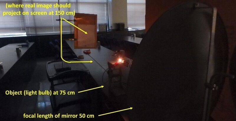

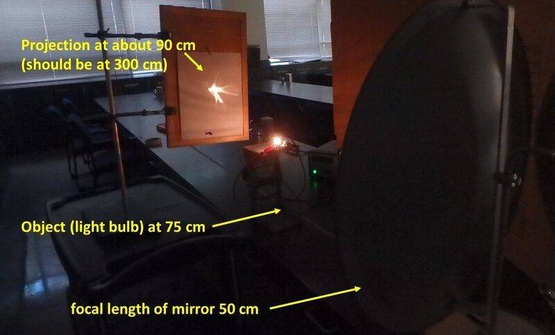

Hi all,
The first image below shows the object at 75 cm for a concave mirror focal length of 50 cm. According to the lens makers equation, the real image should appear at 150 cm and the magnification should be 2. I replaced the object of the previous images with a nice, shiny light bulb (that I hoped would serve as a point-light) because I could not get the previous object to project on any screen, lights on or off.
The "splotch" you see on the board is actually the magnified interior of the light bulb. The projection happens at 90 cm, certainly not at the 150 cm it is supposed to be at. Also, the magnification is enormous, well above double, which is why you can see so much of the light bulb filament. The image is many times magnified above what it should be to see that kind of the light bulb detail.
Below is what you see when I placed at screen where the real image of the light bulb should be.
The real image of the light bulb focuses at only one location, the 90 cm of the previous image and all other images of all other distances are unfocused and magnify the farther back I move the screen. So, at least it seems consistent that there is only one location where the real image appears, but I don't understand why that image is not appearing where it should be, nor have the magnification it should have.
A few things:
Why doesn't the lens maker's equation work for this kind of mirror? It is supposed to be a concave mirror and should easily conform to the lens maker's equation.
Does anyone know of a mirror that really does work well with the lens makers equation? I would really like to work with it. Is the material a factor? Does anyone know something from engineering that they actually worked with that behaved as a concave mirror normally should? Is it possible this concave mirror is not spherical?
This is my progress so far.
Is the focal length 50 cm or 60 cm? And how do you know? You can form a real inverted image located at twice the focal length if you place the object at twice the focal length. In other words, the image can be seen on a screen at the same location as the object if you place them at the center of curvature of the mirror. This technique can be used to verify or establish the focal length.
Pretty sure the focal length was 60 cm, I can check again. I thought the images above were a typo when I looked at them just now in putting 50 cm where I meant to write 60 cm. Now I am not sure if my typo is not the correct focal length.
Its hard to see from the images but I am pretty sure that the object is not at twice the focal length (100-120 cm). Its at 75 cm. When you say "twice the focal length", do you meant the center of curvature, C, of the mirror? Unless of course my focal length is 30-40 cm; I'm pretty sure its not, less sure after this reply, though.
I measured the focal length crudely; where the image flips from upside down beyond the focal length to where it switches to right side up, closer to the mirror within the focal length. I did that as carefully as I could and should be within a few centimeters.

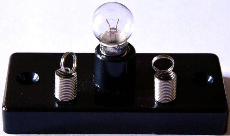

The object is the light bulb below, tuned to about 5 volts and glowing brightly. The light bulb is also placed on top of a lab stand jack. I chose a bright glowing light bulb because it would be easy to see (and hence its image easy to find). When I used the object of the previous post, the blue-yellow balloon, steeple-looking thing, I could not focus its real image on any screen. Can you upload a picture of the frosted lamp you have in mind?---I am certainly willing to try another object.
The screen in which to capture the light bulb image is white paper on the corkboard; that's the top blob of light in the top image. If I should use something different for a projector screen, by all means let me know. I use what is available to me, but would certainly be excited to know that another kind projector screen would make this much easier. I had not considered the material of the projector screen detail before. A part number would be great.
Also, what the camera and what the eye capture are very different. Neither the image or object are nearly as bright and spherical as what the camera captured above. The object, the light bulb, the lower blob of light in the image, does not look this way in person; it is a point-source light bulb as seen with the human eye. The upper image, the blob of light on my makeshift projector--that is the best and sharpest the image could focus at. Any other distance and the image gets larger, less bright, and, by human eye, much less focused. I think you would have to see this in person to be convinced.

It sounds like you have a proper object, screen, and technique. So I would suggest moving the object a bit further away and the screen a bit closer until you get a sharp image with object and image distances equal.
A frosted bulb is just the normal type of incandescent bulb we'd put in a reading lamp. It gives a more even glow with less glare than a bare bulb. But it sounds like you don't need that because you are seeing a clear image of your bare bulb.

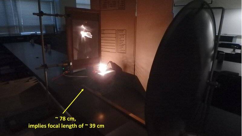

I did the check where the object is much farther (~ 5 meters, 15 feet) from the mirror. The real image showed up at about 38 cm. Thus, it seems that the focal length really is about 38 cm and not the originally 60 cm I posted earlier (and my first test of flipping upside-down to right-side up was much more subjective). From the two tests of q=p and the long-distance test, the focal length is thus really ~ 38 cm.
You can ignore the Oct 5 posting I did now in light of this recent measurement; I didn't even know which image was the "real image" when I posted that, which was the main point of that post. Posting here sorted that out for me.
I will redo the measurement of Oct 7; in that post I erroneously had the focal length at 50 or 60 cm (in two different posts), which has since turned out to be wrong by the better techniques suggested in this post. For a focal length of 38 cm and an object at 75 cm, the image is predicted to appear at 77 cm by the lens maker equation, which is not so far off from the 90 cm in that post; nevertheless, I think I can measure this better having done this a bunch of times. I will attempt on Monday. This does feel like its converging; I just don't have access everyday to my measurements.
