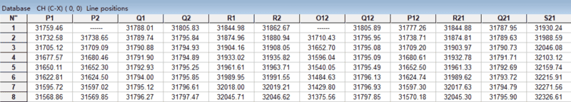

Favry2021
TL;DR
where does the R21, Q21, etc. branches come from?
I have a bit basic understanding of spectrum, but quite confused with LIF spectrum. It seems existing 12 main branches of Laser induced fluorescence, such P1, P2, Q1, Q2, P21, R21,and so on. I know there should be O P Q R S branches of the rotational transitions, but where these so many subscripts, 1, 2, 21, 12 com from? thanks for any help.

Thank you ES for your answer, but still not quite sure.
1. Does the hyperfine rovibronic spectrum necessarily mean 2-photon excitation? Can using a single photon excite a molecule and arrive the same results?
2. I was looking at LIF-base CH C-X (0,0) transitions, which shows all the 12 transition lines as shown in the figure below. If the two digits subscripts means upper and lower F, how about the single digit ones?

I've been reading over this table and it really bugs me. Since there is no row for N''=0, I want to believe that the excited state is a ##\Pi## state (##\Lambda = 1##). However, if that were the case, there would be no P1 line. However, instead there is no P2 line?? So take what I suggested earlier about the single digit subscripts and throw it out the window.
Also, I feel like CH would have nuclear spin I = 1/2 since carbon 12 is an even isotope and hydrogen has I=1/2. Since there's an odd number of electrons, J should have half-integer value and so the subscripts really must be related to F like @EigenState137 was saying or to N. Why the P2 line is missing in the above table is still a mystery to me. Also, if the subscripts are F, isn't O12 also nonsensical? I would expect O31. (Not saying anyone is wrong, just trying to state what I find contradictory here.)

Ok, I finally think I get it. The F quantum numbers you refer to do not include rotational angular momentum, N, right? That's why P12 makes sense for N=3, because the transition is between the F=1,N=3 to F=2,N=2 state. I believe this is where I got hung up, because in Brown and Carrington (where I learned this stuff from), J and F include the rotational angular momentum.
I think I understand the table better now. N" means N of the excited state. So P1 goes from F=1,N=2 to F"=1,N"=1, so both P1 and P2 are allowed. I don't know how to interpret the exclusion of the P2 line. Perhaps it just didn't show up in the data for whatever reason.
With these clarifications of nomenclature, I think the issue is resolved.
