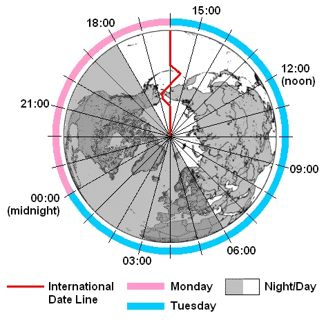

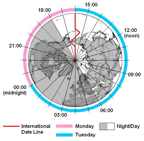

[Sigh] Not sure if this is an exceptionally low effort OP or a crank-yanker, but just to move this along:
Note: the "night" and "day" there is conventional. The actual areas of light and dark aren't shown.
