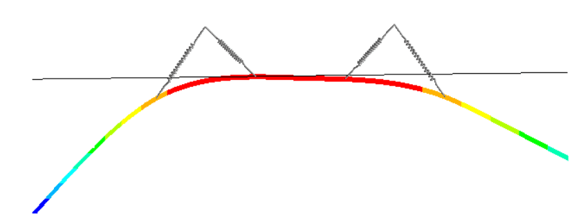

Hi guys,
Just an easy question. Looking at the lifting arrangement below -Do you know if the inner slings (attached towards middle of the beam) works as much as the external ones?
Cheers!

Your crane can't lift that out of balance load (center of mass of red beam is not directly under the crane's cable).

Yeah, let's say there are no external forces, just only self weight. Do you think slings will see the same force?
What do you think about beam stiffness, and its deflection under self weight.
BTW. I suppose it is a well known issue with lifting long soft (not so stiff) structures.
For a perfectly stiff, uniform beam, the slings are all under the same tension. For a real beam, the outer slings or the inner slings could be at higher tension - depends on whether the placement makes the beam 'smile' or 'frown.'

If too slender, both, the spreader and the beam will also tend to buckle under own weight.
