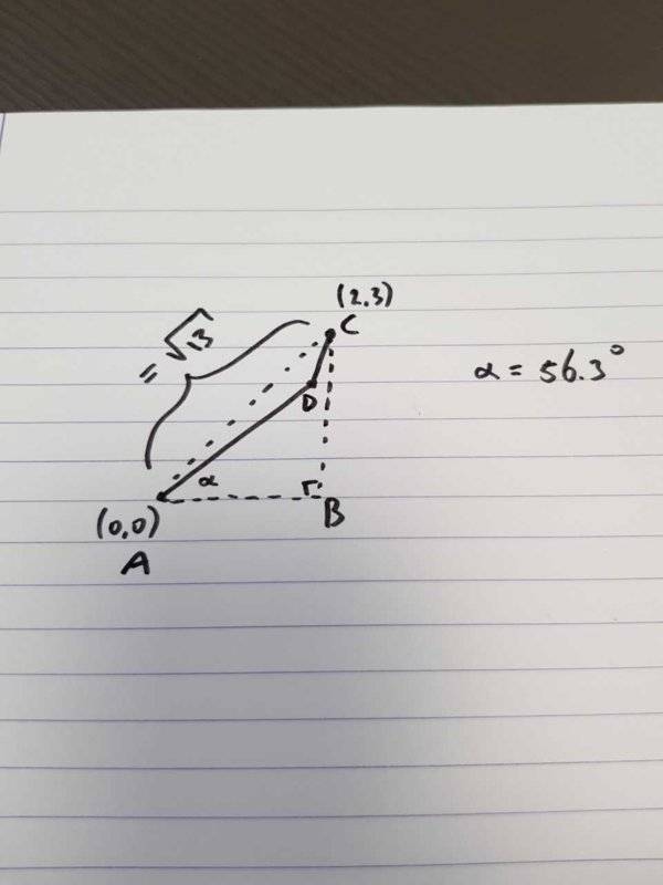

I don't fully understand. For example this is the situation with given parameters and CD has a length of 2.
alpha is the angle in ABC

That's a helpful diagram.
Let CD make angle θ to the vertical (angle BCD) and AD make angle φ to the vertical.
Can you get an equation relating , θ, α and the lengths AC, CD?

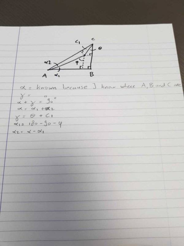

  • #37
haruspex said:
I meant to write
But then there are still two unknowns, namely θ and φ.
  • #38
Doesn’t matter. At this stage we are just trying to find a relationship between them. Next step will be to involve them in force balance equations.
In fact, if you are stuck on getting that relationship, set that aside and move onto the other equations.
  • #39
haruspex said:
