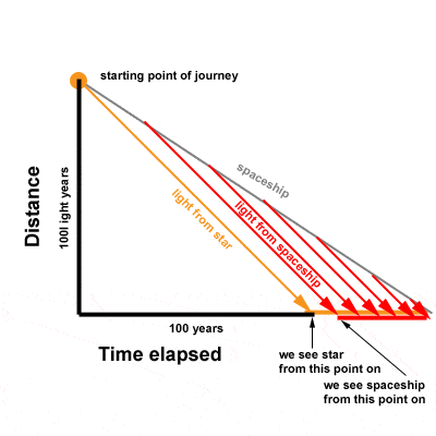

I need your help to figure it out if the following thought experiment makes sense. Imagine two points in space at the same distance from Earth, 100 light years. At one point a previously unknown supernova explodes; we observe it’s bright light in the sky for several months, and after that it fades away. From another point, a super-luminous object comes to us at a near-light speed, and it’s so bright that it’s visible to us through all its way to Earth for almost 100 years. Isn’t there a paradox that we can observe a flash of light only when it reaches us, but in case of the objects coming to us with near-light speed, we can observe them on all their way to us? … or can’t we? In other words, is there a principal difference between travel of light and travel of luminous objects?

That puzzles me, I'll show you why. Suppose, you have synchronized clocks at two close to each other points, both 100 l.y. away. At the same moment, they send to Earth a light flash from one point and from another point - a super-luminous object, traveling at such near-light speed that it takes 100 years and 1 day for it to reach Earth. In 100 years you observe on Earth the light flash coming from the first point and an image of the super-luminous object just leaving the other point. In the first case, it's all clear. But in the second case, there is only one day between the observation of the super-luminous object at starting point and it's reaching the Earth. Isn't it paradoxical that you observe this object covering the distance of 100 l.y. in just one day?

Your "non-enlightened" observer would come to the same conclusion as your "enlightened" observer. The fact that the object arrives one day after he first sees it at 100 ly away tells him that it was traveling towards him at near light speed. The object will be following close behind the light of that first image. That, and the fact that the light from the object will be extremely blue-shifted. He will see 100 yrs of light emitted from the object compressed ito one day.

The object will be following close behind the light of that first image. That, and the fact that the light from the object will be extremely blue-shifted. He will see 100 yrs of light emitted from the object compressed ito one day. Nothing about this is paradoxical.
OK, thank you! That explains everything. I was thinking about it, but I was not sure.

A relativistically traveling spaceship is following closely behind its own light.
When it was 100ly away its light took 100ly to reach us. When it's 100 miles way, it light takes microseconds to reach us.
Yep. It would appear to take only one day from start of journey to arrival. This makes sense. We know the source of light it is in motion.

You don't need to invoke anything so fancy; it is simple geometry.
See attached diagram.
Take a piece of card, like a playing card.
Hold up to your screen with its left edge on the Y-axis.
Sweep the card slowly to the right.
Observe what happens.
