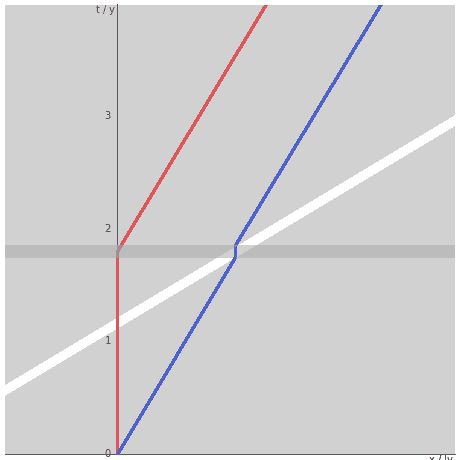

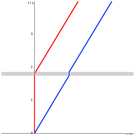

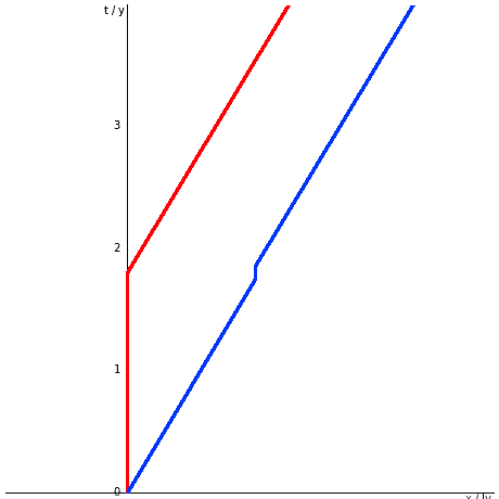

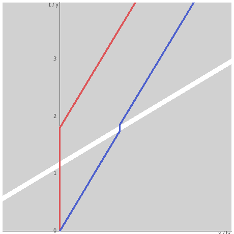

Here are a few Minkowski diagrams detailing your scenario 2 and what I think is going wrong. If you haven't come across Minkowski diagrams before they are essentially displacement-time graphs, with x position recorded on the horizontal axis and time on the vertical axis. Conventionally units are picked so that the speed of light is 1.
Here's your scenario drawn in the Earth's rest frame:
The red line represents the Earth twin, staying at home until 1.8 years, at which point he accelerates to the right. The blue line represents the traveller, moving to the right at 0.6c with the exception of a brief stop about the same time (in this frame) as the Earth twin starts accelerating.
In relativity we take these graphs fairly literally as a map of spacetime. We can mark on it the region of spacetime that the traveller calls "during the first phase of the trip" and "during the last phase of the trip" - that is, excluding the brief stop. These regions are shaded in grey:
And we can draw the region of spacetime that the traveller calls "during the stop" - again, shaded in grey:
Just to hammer the point home, we can draw all of that on one graph:
Here you can clearly see the problem. According to this simultaneity scheme, the Earth twin starts moving twice! Once during the brief stop, and once during the final phase of the traveller's journey. This is, of course, nonsense. The problem is that bolting together three parts of inertial frames like this does not lead to a coherent picture of spacetime, any more than taking two random overlapping screenshots on Google Maps and pasting them side by side makes the contents of the maps appear twice in the real world. It's just a bad map.
You can use it, but in any calculations you do using this simultaneity scheme you need to manually correct for the fact that your map doesn't cover all of spacetime and does cover some bits of it twice. Most probably what you are doing wrong is assuming that because the Earth twin started moving "during" the traveller's stop he must be moving after the stop, which is not accounting for the mess this scheme makes of time ordering.
If you want to be able to tell a coherent story about how the traveller interprets distant events if he's not inertial then you need a non-inertial frame that doesn't have this mess. Unfortunately, the maths for this is rather more complicated than using inertial frames.
