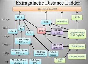

There are various ways of calculating astronomical distances. For stars within a few parsecs, photos taken at opposite sides of the Earth's orbit (six months apart) show how much the position of the star has shifted compared to the background stars much farther away.
Farther than that, Cepheid variable stars are used. These are variable stars whose brightness varies in a regular cycle and the period of that cycle is closely related to the stars brightness. Knowing the absolute brightness of the star allows the astronomers to calculate its distance. Cepheid variables have been seen in nearby galaxies.
Using these two methods, astronomers (Hubble) noticed an approximately linear relationship between distance and red shift. Beyond the distance where Cepheid variables can be observed, red shift is used.
Recently a relationship between a type of supernova and its brightness was observed allowing the distance between those supernovas to be calculated by that method also. It was discovered the red shift versus distance was not as linear as believed, leading to the conclusion that the expansion of the universe is accelerating.

we know its distance from using parallax
we measure the difference in its position at two opposite points on the Earth's orbit (ie, 6 months apart), and use a bit of trig :wink:
for galaxies, we can't use parallax because the difference in position is too small
instead we can use "standard candles" …
particular types of star which always have exactly the same brightness​

Before I answer your question, let me briefly describe spectral types. We assign letters to spectral types, and these are O B A F G K and M. O-type stars are the hottest and bluest (surface temperatures of 30,000 to 50,000 kelvins), and M-type stars are the coolest and reddest (surface temps of 3000 K). Our sun is a G-type star (yellowish-white and surface temp of 6000 kelvins). For more info, just Google stellar spectral types.
On to your question:
There are many stellar properties that vary in a progression across the main sequence. I already mentioned surface temperature and luminosity. Another is stellar radius. Where a star lies on the main sequence entirely determines its radius. So, two main sequence stars of the same spectral type cannot have significantly different radii. Take M-type main sequence stars as an example. These are often called M-dwarfs or red dwarfs. What about a red giant? It's cool enough for it to be red. In fact it has the same spectral type (it's an M-giant). However, it is significantly larger and therefore it will be significantly more luminous. So much so, that it won't lie on the main sequence of the HR diagram. Indeed, the red giant stage of stellar evolution is the stage that many stars enter after their main sequence lifetime is over. (They have fused all of the hydrogen in their cores, and the absence of an internal energy source causes them to evolve off the main sequence). Check out this HR diagram to see where stars in different phases of stellar evolution end up: http://en.m.wikipedia.org/wiki/File:HRDiagram.png
The method of spectroscopic parallax only applies to main sequence stars, which have well defined relations amongst their various stellar properties. Some other method of distance determination would have to be used for a more evolved star like a giant.
You might be wondering why the placement of a star on the main sequence determines so many of its properties uniquely. It's because the fundamental stellar parameter that determines everything else is mass. Where a star will end up on the main sequence is determined by the mass that it has when it forms. A star forms from a cloud of interstellar gas that collapses under its own gravity. But as it collapses, it heats up. This heat (especially after fusion ignites in the core), creates an outward pressure that fights against the inward force of gravity. A star is said to have formed when a balance is achieved between these two forces, and the star is stable (a condition called hydrostatic equilibrium). The more mass that is present, the higher the internal temperature that will be reached before equilibrium. The higher the core temp, the higher the rate of nuclear fusion, and the more luminous the star, and the hotter its surface temp will be. And of course the radius of the star at hydrostatic equilibrium is determined by its mass as well. In this sense, the main sequence can really be thought of as a sequence from high-mass to low-mass stars.
If you have a large star with the same surface temperature as a small star
Well, you do not have this in the main sequence.
