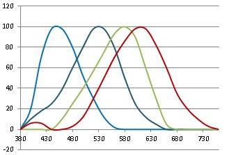

That's fine- I am color-blind, after all. How about this- given the sensitivity curves of human cone cells, explain how red hues are is perceived when the retina is excited by 405 nm light:
https://askabiologist.asu.edu/sites/default/files/cones_graph.gif

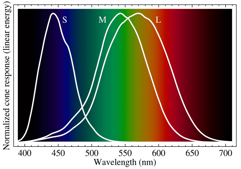

The graph is probably wrong, that's why.
In fact, the number of different graphs on the response of cone cells is high enough that I don't know which ones to believe. Here's a few I quickly found from google images, all different:
As you can see, all three of my graphs are different and all three are different from yours as well. However, almost all of them show that the red photoreceptor still responds, at least a little bit, to light all the way down to around 400nm, and at least one graph (the last one in my post) shows a small 'bump' from 380-430nm where the red photoreceptor apparently regains some sensitivity after dropping to near-zero.

The reason this is tricky stems IMHO from the fact that the "red" CIE response curve has two humps. One of them is in the violet . I believe this drives the other CIE color map
Huh- I'll be a monkey's uncle, you are right! I found this reference, very careful measurements:
https://www.sciencedirect.com/science/article/pii/S0042698900000213?via=ihub
(see especially Figs 4-6 and 9)
Clearly showing the L-cone has sensitivity all the way down to 400nm. Violet is indeed a real color!
