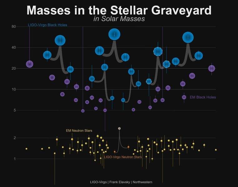

I really like the attached graphic, which shows the LIGO/VIRGO detected events and how the BH/NS masses compare to objects detected by other means.
What is the horizontal axis in that graph? Time?
I'm not really sure, but I don't think the horizontal axis means anything. The objects are just spread out to differentiate them. The arrows indicate the mergers.
