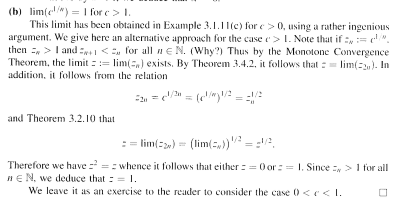

I am reading "Introduction to Real Analysis" (Fourth Edition) b Robert G Bartle and Donald R Sherbert ...
I am focused on Chapter 2: Sequences and Series ...
I need help in fully understanding Example 3.4.3 (b) ...
Example 3.4.3 (b) ... reads as follows:
In the above text from Bartle and Sherbert we read the following:
" ... ... Note that if ##z_n := c^{ \frac{1}{n} }## then ##z_n \gt 1## and ##z_{ n+1 } \lt z_n## for all ##n \in \mathbb{N}##. (Why?) ... "Can someone help me to show rigorously that ##z_n \gt 1## and ##z_{ n+1 } \lt z_n## for all ##n \in \mathbb{N}## ... ... ?Hope that someone can help ...
Peter
Suppose that ##z^n \le 1## for some ##n \in \mathbb{N}##. Then ##c = (z^n)^n \le 1^n = 1##, a contradiction.
Similarly, suppose that ##z^n \le z^{n+1}## for some ##n \in \mathbb{N}##. Then
\frac{z^n}{z^{n+1}} = c^{\frac{1}{n} - \frac{1}{n+1}} = c^{\frac{1}{n(n+1)}} \le 1,
so ##c \le 1^{n(n+1)} = 1##, also a contradiction.

Thanks for the help, Krylov ... just reflecting on what you have written ...
The book ... well ... I was looking for a rigorous text on one variable real analysis that covered the foundations of real analysis well and moderately thoroughly at about senior undergraduate level ... hopefully with detailed and complete proofs ... and I have found that Bartle and Sherbert meets my wishes pretty well ...
