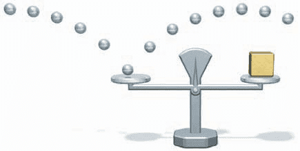

A stream of elastic glass beads, each with a mass of 0.50 g, comes out of a horizontal tube at a rate of 100 per second. The beads fall a distance of to a balance pan and bounce back to their original height. How much mass must be placed in the other pan of the balance to keep the pointer at zero?
[tex] F = \displaystyle{\frac{\bigtriangleup{p}}{\bigtriangleup{t}}} = n.m.v [/tex]
[tex] KE_{initial} + PE_{initial} = KE_{final} + PE_{final}[/tex]
To find the mass in other pan, i need to find the force caused by beads on the pan
∴ KEinitial + PEinitial = KEfinal + PEfinal
0 + mgh = ½ mv^2
=> v = 3.13 m/s
∴ The change in momentum :
p2 - p1 = m ( v2-v1) = m( v - (-v)) = 2mv
∴ F = Δp / Δt = n. m. v
How can i apply the rate of 100 per second in this equation ?

n is the number of particles or in this case glass beads and its unit is 1/s i think ?
and so i think 100/s = 1/ Δt => Δt = 1s/100
=> F = 0.313 N
=> M = 0.313/ 9.81 = 31.9 g

F = Δp / Δt
As i said above, 100/s = 1/ Δt => Δt = 1s/100
so F= Δp / Δt = (2 x 0.0005 x 3.13 ) / (1/100) = 0.313N
the force on this side must be equal to the other pan
so F = M.g => M = 31.9g
hquang001 said:
is it number of beads per second ?
Yes.
Ok, that is right. I was thrown by not having picked up an earlier error. Given your calculation of v, you should have written F=nm(2v).

Is the "original height" to which the beads bounce back given some place and I missed it?
Also, if "v" is indeed 3.13 m/s calculated from energy conservation as shown in posting #1, then it must be the speed.
In that case, the equation
is, strictly speaking, incorrect. If the bead reaches the same height after the collision, its speed must be the same just before and just after the collision and therefore does not change. What changes is the vertical component of the velocity. It would be cleaner to use kinematics to calculate this vertical component just before the collision and label it vy rather than v in the momentum transfer equations.
Oh i missed it, the height should be 0.5 m.
and yes the speed does not change that's why the Δp = m( v -(-v) ) but it's not really clear written as you said

Personally, I would attack this problem from a different angle. Make it about a system. Draw the boundaries of your system at the point where beads enter the system from the left horizontally, at the point where they exit the system on the right horizontally and at the bottom where they interact with the pan.
The number of beads in the system is constant (plus or minus one bead - negligible) and its vertical momentum is constant (on average). So enumerate the places where momentum is gained or lost and write down a momentum balance.
It may be useful to realize that a force and a rate of transfer of momentum over time are essentially the same thing.
