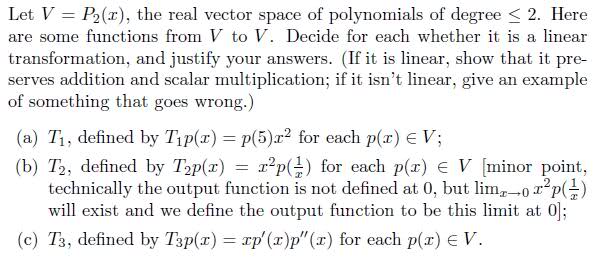

Hi, would someone be able to check my proofs for me and tell me if they are right and if not what is wrong please?
So for the first one I said let u=p(x) and v=b(x)
T(u+v)=p(x)+b(x)=p(5)x2+b(5)x2=Tu+Tv
and T(ku)=(kp)(x)=kp(5)x2=kTu
So it is a linear transformation.
For the second I said T(u+v)=p(x)+b(x)=x2p(1/x)+x2b(1/x)=Tp(x)+Tb(x)
and T(ku)=x2kp(1/x)=k(x2p(1/x))=kTp(x)
So it is also a linear transformation.
For the third I said T(kp)(x)=xkp'(x)kp''(x)=k2xp'(x)p''(x) which does not equal KTp(x)
So it is not a linear transformation
Did I do these right?
Thanks for any help :)
for the first one, what would happen if you took A= x^2 and B=-x^2?
You haven't used the given information that P2(x) is the space of polynomials of degree 2 or less. Every function in this space is of the form p(x) = ax2 + bx + c, for some constants a, b, and c.
So am I suppose to write it out as T(ax2 + bx + c+dx2+ex+f)=[25(a+d)+5(b+e)+(c+f)]x2?
I am a bit confused :confused:
Hm I did it that way and I still get that it is a linear transformation.
Well either way I get zero.
You have some problems with your notation. For instance, you have u=p(x) and v=b(x), so [itex]T(u+v) = T[(p+b)(x)] \ne p(x)+b(x)[/itex].
Right I made that mistake, but I don`t think it affected the wrongness of my answer.
T(u+v)=T[p+b](x)=(p+b)(5)x2. Does this not equal p(5)x2+b(5)x2? I don't understand why not.
I think your conclusions are right.
