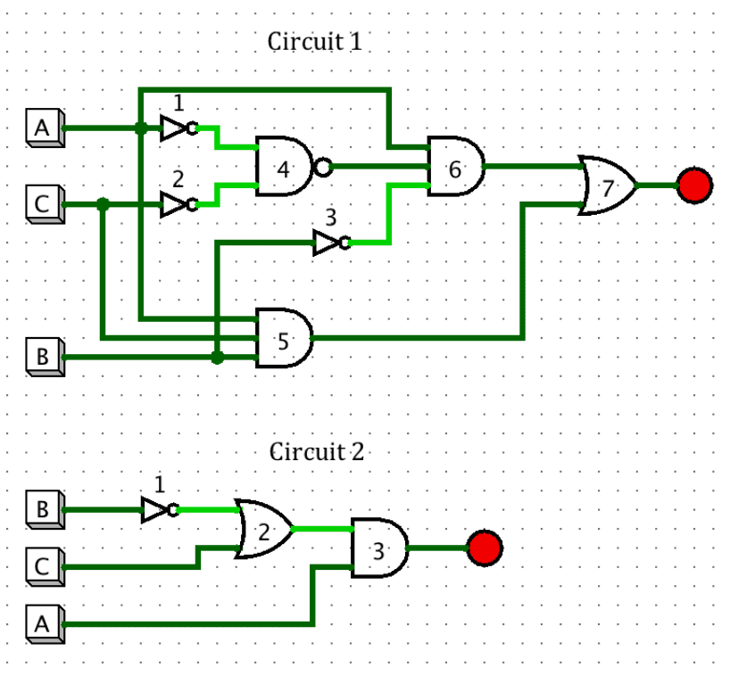

Hey guys, I'm in a pickle with this question. Its really not my cup of tea, its a struggle factor really but I don't really have a choice whether I like it or not. A worked example such as this allows me to see what it is I need to do. If anyone can provide a helping hand it would assist me tons.View attachment 4301The questions is as follows: For each circuit write the equivalent logic expression, truth table showing the final output (O) for inputs (A,B and C) and find if these expressions give the same output (comparing the final output columns)?:confused:

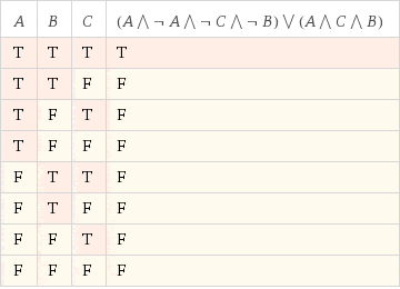

Is this right?: (B' + C) * A Circuit 2
(A* (A' * C') * B') + (A * C * B) Circuit 1
Truth table is a tricky one for me but I attempted them are they right is this what I am supposed to do.
View attachment 4307 (CIRCUIT 2)
View attachment 4308 (CIRCUIT 1)
  • Truth table with columns A, B, C and (¬B ∨ C) ∧ A, listing all eight combinations of T and F for A, B and C with the resulting output column.
  • Truth table with columns A, B, C and the expression (A ∧ ¬A ∧ ¬C ∧ ¬B) ∨ (A ∧ C ∧ B), eight rows of inputs; only the first row, where A, B and C are all T, gives T, and every other row gives F.

Great work. You have done everything almost correctly. :)
The only mistake I see is in the expression for circuit 1. Note that gate 4 in that circuit is a little different from the ones I mentioned. It's called a NAND gate. A "NAND" gate is basically a AND gate followed by a NOT. That is if the inputs to a NAND gate is say $x$ and $y$ it will output, $(xy)'$. That is it multiplies the inputs and then take the compliment.
So there's a little thing that should be corrected in your expression for circuit 1. And accordingly the truth table will also have to be changed. :)

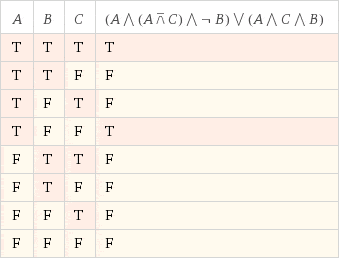

Is this right: View attachment 4312 AND how do I compare do I just say that they are the same.
  • Boolean expression: (A AND (A NAND C)) AND (NOT B)) OR (A AND C AND B)
  • Truth table with columns A, B, C and the output of (A ∧ (A NAND C) ∧ ¬B) ∨ (A ∧ C ∧ B), eight rows, output T in the first and fourth rows and F in the others.
HELPMEHELPME said:
Is this right: AND how do I compare do I just say that they are the same.
Please do not duplicate posts, just one reply would be more than enough as I get a notification for each of the threads I have subscribed. :)
What you have written in post #3 is almost correct. All you got to do is to take the compliment after you take the product for gate #4. That is the expression should be,
\[(A* (A' * C')' * B') + (A * C * B)\]
Note that since the inputs of gate 4 is $A'$ and $C'$ we have $(A'C')'$ as the output for that gate. Can you write the truth table for this?

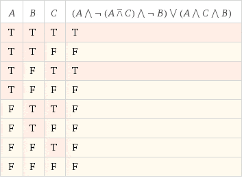

This is what I got, is this right: View attachment 4317
  • Truth table with columns A, B, C and the formula (A ∧ ¬(A ⊼ C) ∧ ¬B) ∨ (A ∧ C ∧ B), with eight rows of T and F values for each input combination and output column.
Almost. Check the fourth row again. Everything else is correct. :)

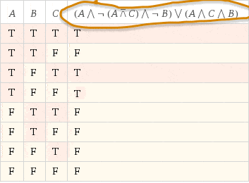

I suppose the two circuits are supposed to be equal. Am I right? Is the equation that I have correct or do I have to change it. Is my table right now.
  • Truth table with columns A, B, C and a formula (A ∧ ¬(A ⊼ C)) ∧ ¬B) ∨ (A ∧ C ∧ B), eight rows of T and F values, with the formula column circled in orange.
Great. Your table is correct now. Using Boolean logic it can be shown that the two circuits are in fact equivalent. Let us try to simplify the expression for the 1st circuit.
