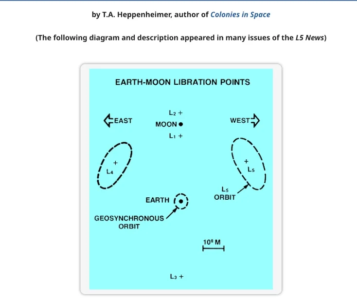

I think the bigger issue is if the orbit of the rod itself is stable. Of the five LaGrange points in the Earth-Moon system, two are stable, L4 and L5. Factoring the sun, they become regions of stability. All this was worked out in the 1970’s when there was interest over hypothetical space colonies. Back in the day I joined the L5 Society which advocated building O’Neill style colonies at L5.
https://nss.org/what-is-l5/
