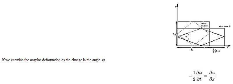

Hi,
The attachment below is about strain rate in fluids*. It shows how the strain rate [tex]d\phi/dt[/tex] is related to the velocity field derivative [tex]du/dx[/tex] when you stretch the element in x (i.e. longitudinal strain).
It has no intermediate steps, and I can't see how the angle has been related to the velocity field (or where the 0.5 factor comes from).
Thanks very much.
*From website: http://www.see.ed.ac.uk/~johnc/teaching/fluidmechanics4/2003-04/fluids5/stress.html
Sorry about the small picture - that's how it is on the website.
  • Diagram of a fluid element deforming by shear: a square outline with a rhombus shape showing angle phi, with dimensions delta x and delta y, and the equation -(1/2)(d phi/dt) = du/dx below.
I would assume there's a simple trigonometric identity to apply. What makes this difficult for me is that phi is present in both the x and y directions, whilst the equation somehow describes it through the x-axis.
