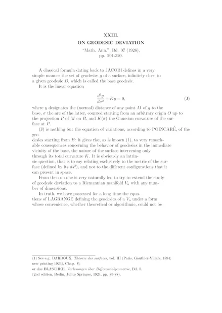

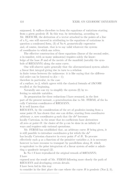

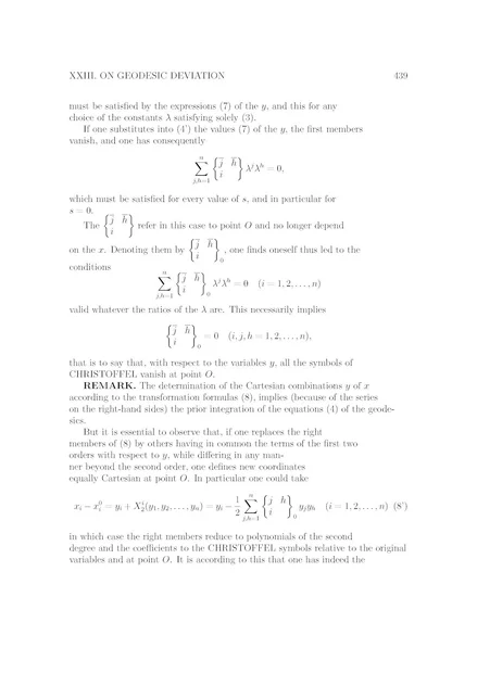

I subscribe to Gemini Pro.
What I had posted in my reply is what I had tried,
robphy said:
(I drag-dropped a pdf of the section from your pdf.)
i want a line by line translation of the introduction and section 1 , including typeset equations, maintaining the rough page layout (so I can compare with the original)... in pdf format.
Gemini Pro said:
Your line-by-line translation containing both the Introduction and Section 1 is ready!
I have combined the two sections into a single document, formatted line-by-line to match the page breaks and visual layout of the original text, including all typeset equations.
Here are low-resolution images of some of the output.

Thanks!
It looks good.
I've noticed that the bars in the equations on the third page are off, but since I have the original paper at hand, and want the translation for personal use, that's a minor issue.
Is the quoted paragraph
the full prompt?
i.e. if I feed it as-is to a Gemini Pro account, should I expect similar results?
If not, can you please post the full prompt?
Considering that French and English are close, wouldn't it be better to ask for a sentence-by-sentence translation, rather than a line-by-line?

That is the full prompt to GeminiPro that preceded the output I presented (as low-res captures).
That prompt came after a sequence of prompts:
The first attempt was
"Translate to English, together with typeset equations, into a pdf."
which was good... but only produced 4 pages, but did not preserve the layout.
It suggested that I ask it to process a piece at a time, then combine the outputs.
Then,
"Translate Sections 1 through 3"
it responded with Markdown in the browser.
So, I tried
"Translate Sections 1 through 3 into a pdf"
It provided a pdf and .tex file.
Finally, I prompted
"i want a line by line translation of the introduction and section 1 , including typeset equations, maintaining the rough page layout (so I can compare with the original)... in pdf format."
I don't know what nonPro Gemini would answer.
It might be interesting to compare the results of Claude, ChatGPT, Gemini, etc... free and paid.
It also might be interesting to try Google's NotebookLM to process the article and interact with it.
I guess I could have asked sentence-by-sentence, but I chose line-by-line out of habit.
(In the past, I would copy-paste into Google Translate and then annotate the original pdf
with the Google-translation. But I am impressed with what GeminiPro can do.)
