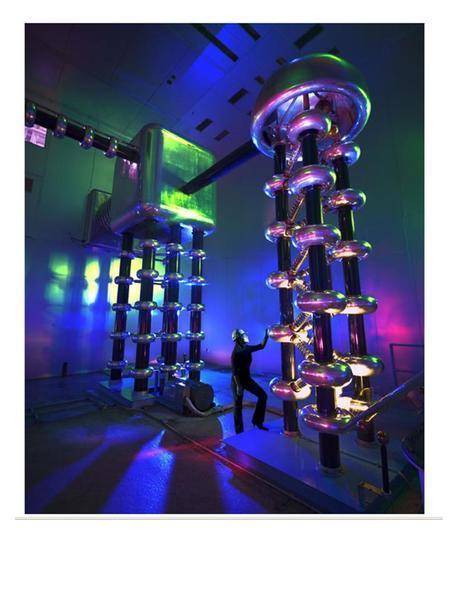

The attached photo shows the 750,000-volt Cockroft Walton at Fermilab. The tower on the right is the Cockroft Walton. The tower at left is the high voltage shield with the ion source. At the base is a multi-horsepoawer motor. There is a vertical Lucite or Plexiglass rod, ~2" or 3" in diameter, that the motor runs to drive an alternator inside the high-voltage shield. Unfortunately, the rod is hidden from view. It was built ~1970. I do not know of anybody who remembers where it came from.
Bob S
