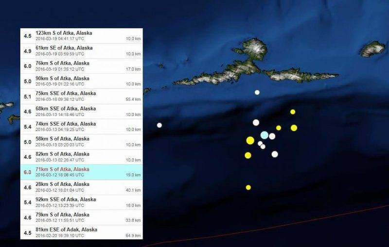

There is a swarm of earthquakes in the area. It was lead off by a Mag 5.0, which was followed by the Mag 6.0.
http://earthquake.usgs.gov/earthquakes/eventpage/us20005axu#general_region
2016-03-19 01:35:12 (UTC)
Location: Lat. 51.513 °N, Long. 174.234 °W
Depth: 17.0 km (10.6 mi)
http://earthquake.usgs.gov/earthquakes/eventpage/us20005axl#general_region
The Mag 5.0 occurred 2016-03-19 01:22:16 (UTC)
Location: Lat. 51.380 °N, Long. 174.265 °W
Depth: 10.0 km (6.2 mi)
There were a bunch of 4.0-4.9 in the region following the first two.
actually these are just ongoing aftershocks to a M 6.3 just over a week ago :wink:
which was preceded by several foreshocks
M 6.3 - 71km S of Atka, Alaska
Time: 2016-03-12 18:06:45 UTC
Location: 51.561°N 174.027°W
Depth: 19.0 km
cheers
Dave
Depth: 19.0 km
Yeah - I had intended to mention that one. I got distracted this afternoon.
I wonder if we'll see a larger one in the region.
no probs, I just didn't know if you knew it was part of an earlier larger event
your text sort of indicated that you didn't :wink:
so posted just in case :smile:
Dave
