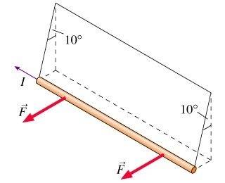

A long, straight wire with linear mass density of 45g/m is suspended by threads, as shown in the figure . There is a uniform magnetic field pointing vertically downward. A 7.0A current in the wire experiences a horizontal magnetic force that deflects it to an equilibrium angle of 10 degree. What is the strength of the magnetic field B?
B=(U_o I) / (2 *3.14 * r)
I have U_0 given, I given. but can't find r.
How can find r to get B?
  • Diagram of a horizontal wire suspended by two angled threads from a slanted plane, each marked 10°, with current I along the wire and two red force arrows labeled F pointing outward and downward.
The equation that you have quoted gives the magnetic field produced by a very long wire. It is not relevant here. What equation do you know that gives the force on a current-carrying wire segment in a magnetic field?
That's the right equation.
The next step is to draw a free body diagram and balance the forces.
