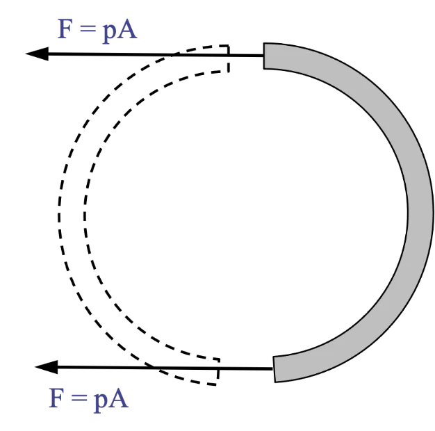

Look at the figure on the right. The total force holding the right half in place is ##F_{\text{total}}=2pA## where ##A## is some appropriate cross sectional area.

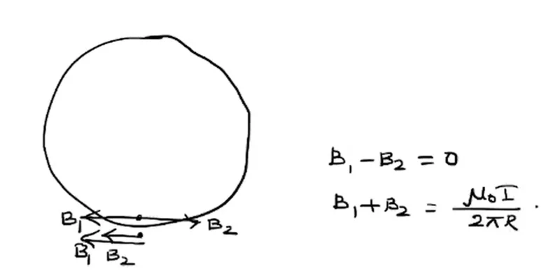

also, I think I have found the answer to my question.
let ##B_2## be the magnetic field due to the rest of the cylinder and ##B_1## be that due to the current element alone. then, if we assume that the magnetic field magnitude does NOT change considerably inside and outside the cylinder, then ##B_1=B_2## and ##B_2=\frac{\mu_0 I}{4\pi R}##
(##B_1-B_2=0## as we may say by ampere's law that ##B_{in}=0##)
so they key thing was that, I had to take the magnetic field due to the REST part, excluding that of the current element in consideration.

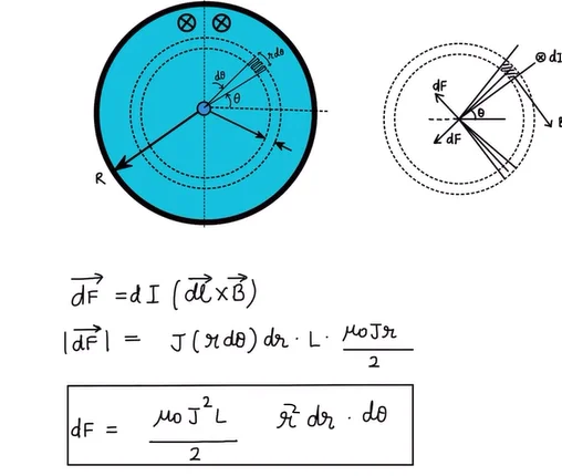

However, this logic does NOT seem to apply in this very similar case: (refer:https://physics.stackexchange.com/q...between-two-halves-of-a-current-carrying-wire)
where the same problem is considered, except the cylinder is solid. Here is the approach suggested online, which yields the CORRECT answer:
(I hope the diagram is self-explanatory, the approach is same as what I had done in my second method.)
Here, even though the field due to the elemental current itself is NOT ignored, integrating over the horizontal component gives the correct answer.
