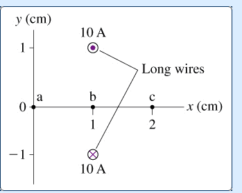

a. What is the magnitude of the magnetic field at point a in the figure?
b. What is the direction of the magnetic field at point a in the figure?
c. What is the magnitude of the magnetic field at point b in the figure?
d. What is the direction of the magnetic field at point b in the figure?
e. What is the magnitude of the magnetic field at point c in the figure?
c. What is the direction of the magnetic field at point c in the figure?

Attempted solution
a. for magnetic field B at point a,
magnetic field, B=U*I/[2*pie*r], where U=4*pie*10^-7, r is the radius, I=current
so, magnetic field at point a is; B= [(4*3.14*10^-7)*10]/[(2*3.14*0)]
therefore B=0 T
b. direction of the mag. field is to the right.
c. magnetic field B at point b,
B= [(4*3.14*10^-7)*10]/[2*3.14*1]= 2*10^-6 T
d. direction of the mag. field is to the left
e. magnetic field, B at point C
B= [(4*3.14*10^-7)*10]/[2*3.14*2]
B=1*10^-6 T
f. direction of the mag. field is up.
