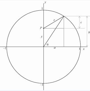

I don't think I did this correctly... I probably did some thing(s) wrong... So if someone can please correct me that would be great! I hope I'm not too far off though...Consider the loop lying in the xy-plane as the following image shows:
To simplify the expressions a bit I chose the radius of the loop to be 1.
The point P is the point on which I'm going to calculate the magnetic field. This point lies on the y-axis, a distance y from the origin.
The distance r from point P to any point on the loop can be calculated as follows:
Because of the right triangle:
r^2 = a^2 + c^2 = a^2 + (b-y)^2
a follows directly from the angle \theta, and the some goes for b:
a = \cos \theta
b = \sin \theta
So we find:
r^2 = (\cos \theta)^2 + (\sin \theta - y)^2Now, the length of a small piece of the loop dl is simply the radius of the loop multiplied by a small angle d \theta. Since the radius is 1:
dl = d \thetaNow finally for biot-savart's law we get:
dB = \frac{\mu_0 I}{4 \pi} \frac{d \theta}{(\cos \theta)^2 + (\sin \theta - y)^2}
B = \frac{\mu_0 I}{4 \pi} \int_0^{2 \pi} \frac{d \theta}{(\cos \theta)^2 + (\sin \theta - y)^2}

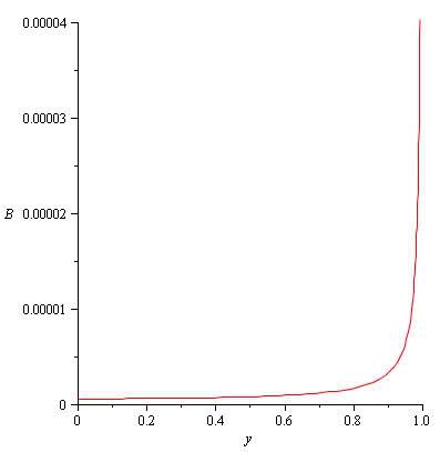

I hope this is somewhat correct or only a bit in the right direction... I have little hope though, since when I tried to compute the integral using Maple I got something with complex logarithms...
However, I did try to plot the function for y from 0 to 1 (I = 1 A) and got the following graph:
The field goes to infinity for y = 1 which is what I would expect (being inside the wire). I have no idea however if the general shape is correct at all...
EDIT
However, for y = 0, I get the same result as the usual 'field in the center of the loop' which is:
B = \frac{\mu_0 I}{2R} = \frac{1}{2} \mu_0 (center of loop with I = 1A and R = 1m)

what direction would the field be in? do all the directions that aren't point towards Z necessarily cancel or do u have to consider them seperatley for each small piece of wire.
Directly from Biot-Savart's law:
\vec{dB} = \frac{\mu_0}{4 \pi} \frac{ \vec{dl} \times \vec{e_r} }{r^2}
(where \vec{e_r} is the direction of r)
If you look at any point on the loop for dl, and any point somewhere inside the plane of the loop for the point P (form which you calculate r), you will see that everywhere inside the plane of the loop, the magnetic field will be directed perpendicular on the plane (wether 'into the page' or 'out of the page' depends on the direction of the current ofcourse)
