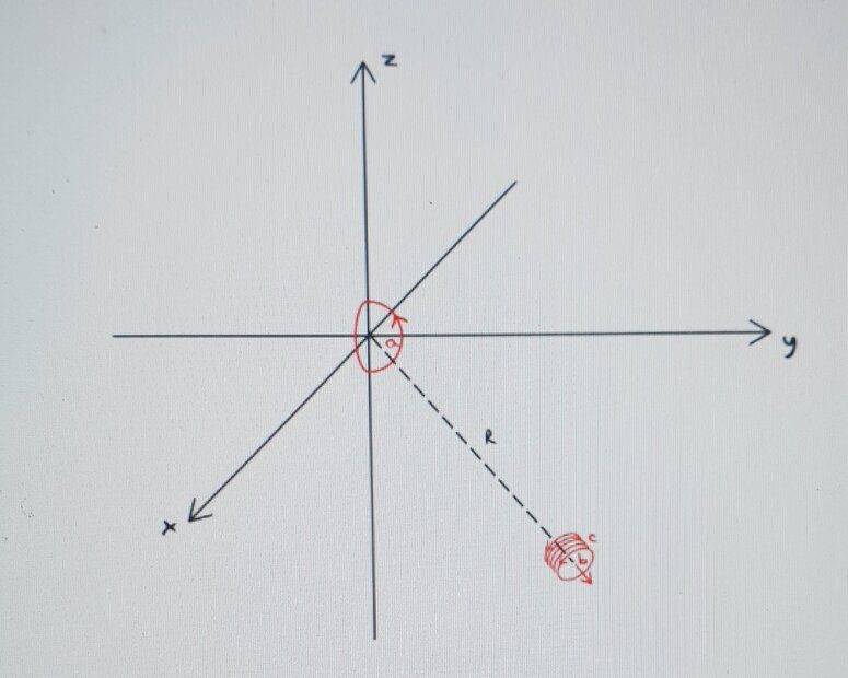

A closed current loop consists of two semicircles with the radius and center at the origin. Den
one is in the yz plane and the other in the xz plane as the figures on the left above show. On a
very large distance R from the origin is a short solenoid coil with N turns, radius b, length
c, center of the point ##( \frac{R}{ \sqrt (2) }, \frac{R}{\sqrt 2}##, 0), and the axis along the diagonal of the xy plane, as the figures shows. We assume that R >> a, R >> b, R >> c
a) Determine the magnetic dipole moments for the loop at the origin and for the solenoid.
b) Determine the mutual inductance of the two loops
