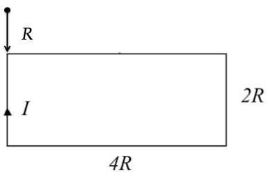

Find the magnetic field at the point distance R outside a rectangular loop of sides 2R, 4R carrying current I as shown in the attached diagram
4bZvS1zgrPJ7p_U1p0n4xRCJrHrjaTgm3GovX7cX1DxrcWbRVlBZjUodEhgqNt8YTq2Q_VxHCZQeZS65Oqk6yLr1JhfWnUbA.png
Biot-Savart Law
iOj7251a0abeL8eOAH_Ykg5QrnyZabcOLgI-r77LlH2q7d3IRXdsar6Gp0IhSnKJvY8tfLzW-TfCvGIgFoC3FF1nz8UUthIA.png
Could I just break this up into 4 separate lines and then calculate using the Biot-Savart Law for a finite wire? The magnetic field at the point, P, would then be the sum of the magnetic fields due to each line, no?

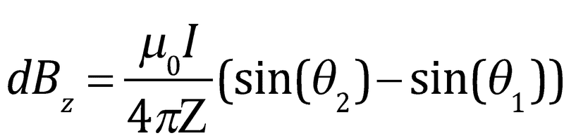

Ok, so I used the equation that I mentioned in my OP.
dBz = μ0I / 4πz ⋅ (sinθ2-sinθ1)
For the top and bottom lines of the rectangle sinθ1 = 0 so dBz reduces to:
dBz = μ0I / 4πz ⋅ (sinθ2)

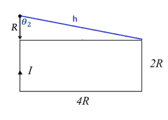

I was using z as the hypotenuse, which I think is where the confusion has come from. I've renamed the hypotenuse to h for simplicity
dBz = μ0 I / 4πz ⋅ (sinθ2-sinθ1)
z = R (for the top line of the rectangle)
For the top line of the triangle dBz reduces to:
dBz = μ0 I / 4πR ⋅ (sinθ2)
sinθ2 = R/h
Therefore:
dBz = (μ0 I / 4πR) ⋅ (R/h)
dBz = (μ0 I / 4πh)
Expressing the answer in terms of R:
dBz = (μ0 I / 4π√(R2 +(4R)2)
Note that θ2 is the angle shown:
So, sinθ2 ≠ R/h. Otherwise, I think your work is OK.

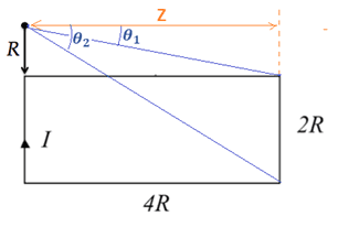

For the right hand side of length 2R, the meaning of Z, θ1, and θ2 are as shown
sinθ2 = 3R / √((4R)2 + (3R)2)
sinθ1 = R / √((4R)2 + (R)2)
dBz = μ0 I / 4π4R ⋅ [sinθ2 - sinθ1]
dBz = μ0 I / 16πR ⋅ [3R / √((4R)2 + (3R)2) - R / √((4R)2 + (R)2)]
I'm not sure what to do for the left hand side of the rectangle. If both sinθ cancel, do i integrate 'R' from 3R to 0?
What are the values of θ1 and θ2 for this side? What does the formula for B give?
Or, apply the Biot-Savart law to an infinitesimal length dl of this side of the rectangle.
