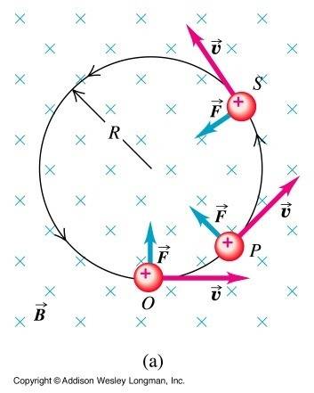

No, B will not be out of the screen. Look at the image.
is there an alternate version to the right hand rule? i pointed my index finger towards velocity vector, and the force vector inwards using my middle finger, which gave me the magnetic field pointing outward. i understand that the positioning would be different each time, but is there any particular way to "start" the right hand rule interpretation?
using this picture, the magnetic field is represented by the middle finger. but before, in other questions, the direction of the thumb indicated the magnetic field. why does the representation change?
I have seen a couple variations to the rule. If you are not comfortable with it yet, I would stick to the one in your textbook. You want to ensure all three vectors are mutually perpendicular, and pointing a way from a common point (like an origin).
It depends on the sign of the charge. This charge is positive, the other is negative. The right hand rule works for positive charges. If the charge is negative, you have to visualize the vector pointing in the opposite direction that the right hand rule tells you.

OH! FLASHBACK! i just remembered an unconsciously learned moment from class. our prof actually DID say that negative and positive charges will change the RHR directions. thanks sandy.bridge for reminding me. won't forget it for my test tomorrow :D
but getting back to the question, how do i get around solving the questions? so the velocity is towards positive x direction, force is towards positive y, and magnetic field is pointing into screen (negative z direction).
