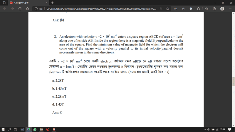

An electron with velocity v =##2 \times 10^6 \\ \mathrm {ms^-1}##
enters a square region ABCD (of area a = ##1 \\ \mathrm cm^2##
along one of its side AB. Inside the region there is a magnetic field B perpendicular to the
area of the square. Find the minimum value of magnetic field for which the electron will
come out of the square with a velocity parallel to its initial velocity(parallel doesn't
necessarily mean in the same direction).

##\vec v= 2 \times 10^6 \\ \mathrm{ms^{-1}}##Since magnetic field is perpendicular to the surface that's why I took ##\vec v \times \hat r=||v||## Wait a minute, Magnetic field is perpendicular but not velocity and velocity is parallel so ##\vec v \times \hat r=0##. But if I tried it then I would get "nothing". Did I take wrong equation? Or there's some concept which I haven't figured out?

IMO, it would be better if the question stated simply what it wants you to find. You are aked to calculate the minimum strength of the magnetic field so that the electron exits the square in the direction opposite from the direction it was fired in.
To do the problem you must know or calculate the shape of the trajectory of a charged particle in a uniform magnetic field.
