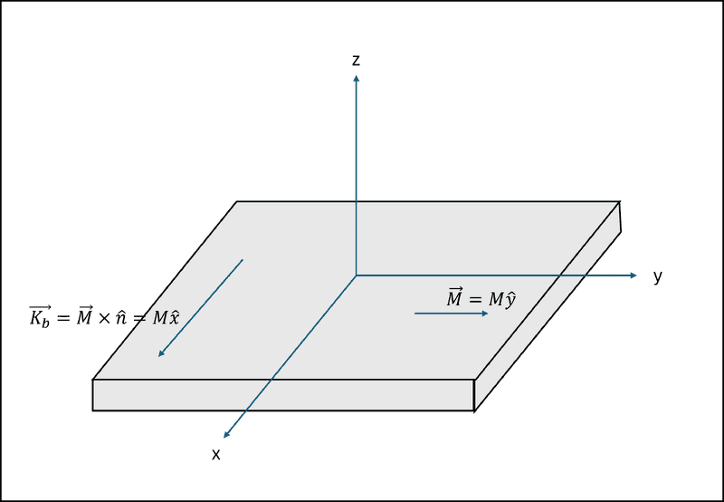

Find the magnetic field above a uniformly magnetized infinite slab of thickness 2d using the Ampere's Law and the magnetic vector potential.
$$\oint \mathbf{B} \cdot d\mathbf{l} = \mu_0 I_{\text{enc}}$$
$$\mathbf{A}(\mathbf{r}) = \frac{\mu_0}{4\pi} \int \frac{\mathbf{M}(\mathbf{r}') \times (\mathbf{r} - \mathbf{r}')}{|\mathbf{r} - \mathbf{r}'|^3} \, d\tau'$$
The bound surface current is $$\mathbf{K}_b = \mathbf{M} \times \hat{n}$$ which gives $$\mathbf{K}_b = {M} \hat{x}$$
Applying ampere's law: ##\oint \mathbf{B} \cdot d\mathbf{l} = \mu_0 I_{\text{enc}}## to the top surface, which encloses the bound surface current yields: ##\mathbf{B} = \mu_0 {K}_b##
This is in alignment with Griffiths Electrodynamics 4th edition example 5.8 for a surface current.

So I have made a mistake somewhere and cannot see it. Can anyone please provide some insight? While the solution is important, I really want to understand where I am making a mistake in this method. This method works perfectly for the uniformly magnetized/charged sphere and cylinder so I see no reason why it shouldn't work here.

This integral automatically includes the contributions from the surface currents on the top and bottom of the slab. Since we know both surfaces produce ##\mathbf B = 0## outside the slab, it makes sense that you get an expression for ##\mathbf{A}## outside the slab whose curl is zero.
If you calculate the integral for ##\mathbf r## inside the slab, you will get an expression for ##\mathbf A(\mathbf r)## whose curl yields the correct nonzero ##\mathbf B## inside the slab.
Yes, that's it. I was missing the fact that the vector potential equation includes both the top and bottom automatically while in Ampere's Law I chose to enclose just the current in the top surface. Upon enclosing both the top and bottom surface I do of course get zero B-field.
