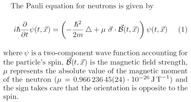

OK, so the particle ##P## is something like a neutron. Let's assume that both ##P## and the moving-charge are nonrelativistic. Then the wavefunction ##\psi_P## for ##P## has two components (representing spin up/down) and satisfies the nonrelativistic Schrödinger-Pauli equation:
https://arxiv.org/pdf/2312.01079
(In (1) the ##\vec{\sigma}## are the three ##2\times 2## Pauli matrices.) Now all you have to do (!) is insert your classical expression for the magnetic-field ##\vec{\mathcal{B}}## of the moving charge into (1) and then solve for ##\psi_P## and you're done.

OK, so the particle ##P## is something like a neutron. Let's assume that both ##P## and the moving-charge move non-relativistically. Then the wavefunction ##\psi_P## for ##P## has two components (representing spin up/down) and satisfies the Schrödinger-Pauli equation:
(In (1) ##\vec{\sigma}## are the three ##2\times 2## Pauli matrices.) Now all you have to do is insert your expression for the magnetic-field ##\vec{\mathcal{B}}## of the moving charge into (1) and then solve for ##\psi_P## and you're done.

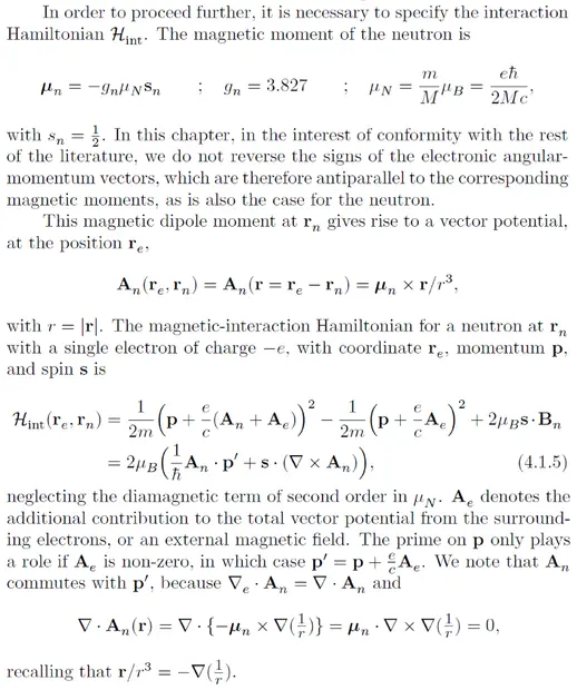

Take a look at MAGNETIC SCATTERING OF NEUTRONS. It considers the scattering of a neutron from a (charged) electron and considers the following interaction Hamiltonian:
It should be applicable to your problem with three provisos:
1) You'll have to flip ##e\rightarrow -e## to accommodate your ##+##-charged particle.
2) You can ignore ##\vec{A_e}## since you deal with only a single charged particle and there is (presumably) no external magnetic field.
3) Equation (4.1.5) ignores terms of order ##(m_e/m_N)^2##. You need to specify ##m_+/m_0## to see if this approximation is valid in your case.
