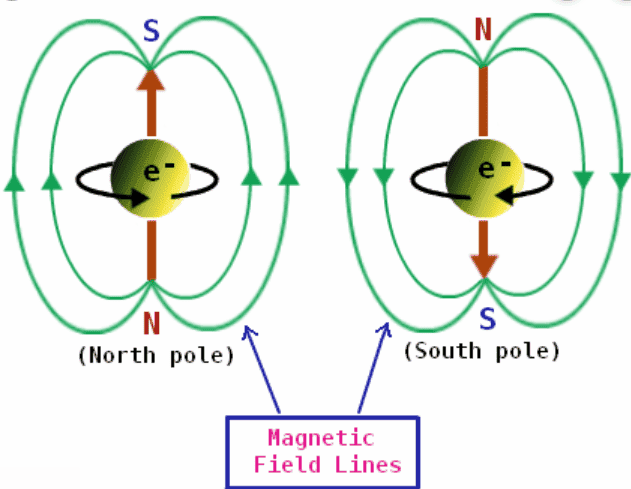

My understanding of quantum physics is very basic. I have read that each electron has its own magnetic field; in other words, each electron acts like a mini bar magnet. I was reading about Lenz's law and an unrelated point started confusing me.
I was reading this text about Lenz's law: https://imagizer.imageshack.com/img921/1874/nUBPY6.jpg
Source: https://www.electrical4u.com/lenz-law-of-electromagnetic-induction/
If each electron really acts like a mini magnet then a stationary bar magnet situated close to the coil should attract the coil electrons by aligning their magnetic fields and create potential difference across the coil. I know what I'm saying cannot be true because it would result into a free energy generator. But this also means that the way I'm picturing electrons as mini bar magnets is also wrong. Does the bar magnet, or non-varying magnetic field in general, affect the electrons in a stationary conductor in any way?

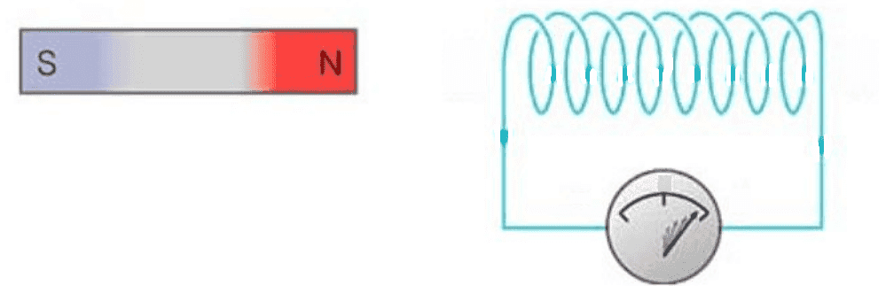

In the picture below, the coil has free electrons and each electron acts like mini magnet. The bar magnet would try to align the south pole of electrons toward its north pole, and it would result into a potential difference or current if the circuit is complete. If the circuit is not complete then the bar magnet would attract as much electrons as it could until the electrostatic repulsion/attraction balance the outward attraction force from the bar magnet.

Mentz114 said:
Even if you were correct in this, the situation you describe could result only in a static charge difference which will only produce a momentary discharge current.
If I'm correct, it would be a constant continuous current because the bar magnet would keep on attracting the electrons and the electrons would start circulating in the circuit.
Thank you for your time and help!
##{\displaystyle {\mathcal {E}}=-{\frac {\mathrm {d} \Phi _{B}}{\mathrm {d} t}},}##
There will not be any circulation unless there is work done.
