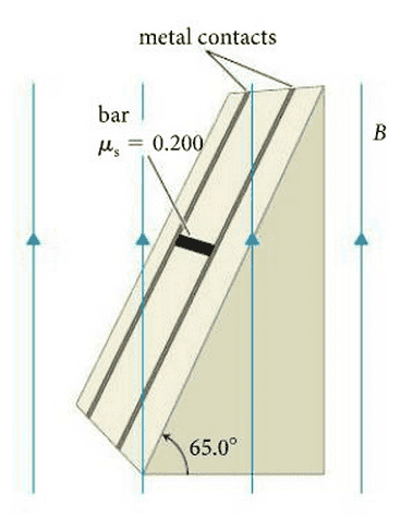

A metal bar with a length L has a mass of m. Initially it is placed on an incline θ above the horizontal. There is a magnetic field T that is directed upward around the bar and the metal contacts along the incline allow a current through the bar. If the coefficient of static friction is μ,
a). What are the minimum magnitude and the direction of the current that must pass through the bar to keep it from moving once released?
b). Is there a maximum current that can be used in that same direction that will also hold the bar in place?
Diagram of a metal bar on a 65.0° incline with metal contacts along the top rails, labeled μs = 0.200, with upward-pointing vertical magnetic field lines labeled B.

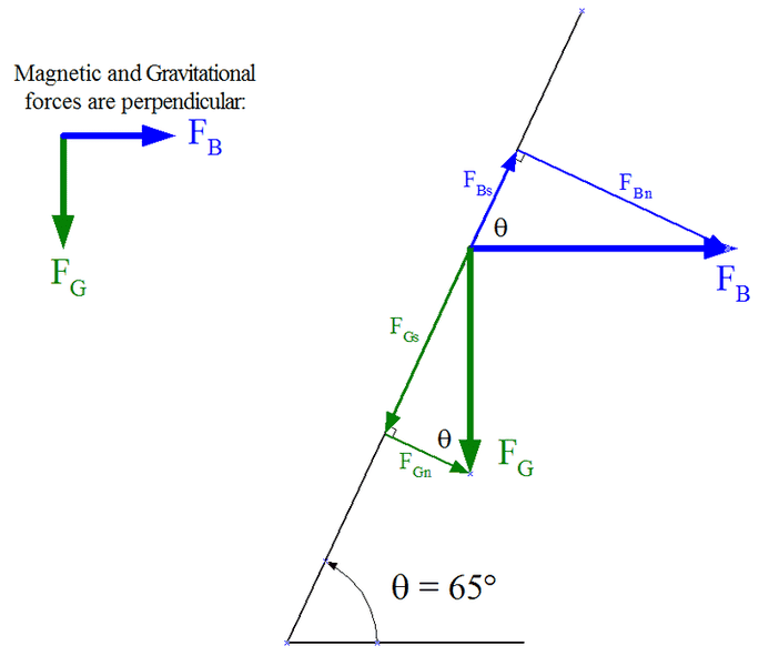

The magnetic force is horizontal, so there will be vector components of that force which are parallel to the slope and perpendicular to the slope ("normal" force"). We do the same thing with the gravitational force.
Free-body vector diagram of a block on an incline at 65 degrees, with horizontal magnetic force FB and downward gravitational force FG resolved into components parallel (FBs, FGs) and normal (FBn, FGn) to the slope.
You should be able to work out where to use sine or cosine from the figure above.

I think you've got it. Essentially static friction opposes the net resultant of any other forces that want to make the object move along the surface.
You can imagine a situation where the gravitational and magnetic forces are balanced in such a way that there is no net upslope or downslope force. The system would be in equilibrium with or without friction. In such an equilibrium state the static friction would be zero, since the object isn't "trying" to move. Now suppose the magnetic force were to increase slightly so there's a net upslope force force resulting from the sum of the two field forces (gravitational and magnetic fields). The static friction would then operate to prevent movement, so it would be directed downslope. In a similar manner, if the magnetic force were to decrease a tad and there was a net downslope force, the static friction would point upslope to oppose it and thus prevent motion. The object actually moves when the net upslope or downslope force exceeds the maximum static friction force.
Of course, any frictional forces will vary with the size of the net normal force. So be sure to take into account the normal forces due to both field forces.
