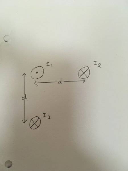

A) Three infinite, current-carrying wires are arranged as shown below. In terms of the given quantities, determine the magnitude and direction of the magnetic force per length acting upon wire 2. (Part A.jpg attached)

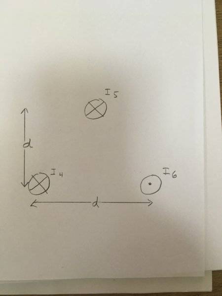

B) Three infinite, current-carrying wires are arranged as shown below in terms of the given quantities, determine the magnitude and direction of the magnetic force per length acting upon wire 5.(Part B.jpg attached)

A) Both wires 1 and 3 create a magnetic field at the location of wire 2.
Wire 1's magnetic field points straight upward in the j-hat direction.
Wire 3's magnetic field points at a -45° angle from the positive i-hat direction which is from left to right.
Using right hand rule:
F1 on 2 is in the positive i-hat direction
and
F3 on 2 is -45° from the negative i-hat direction

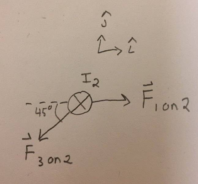

These forces are shown in (forces.jpg)
F1on2=I2LB1i-hat
B1=(μ0I1)/(2πd)
therefore:
F1on2=(I2I1LB1)/(2πd) i-hat
F3 on 2=I2LxB2= here is where I am stuck- when doing the cross product here is the θ the angle between both wires? I guess I am confusing the cross product we do for magnetic field and the one we do for forces..
Any help would be appreciated!

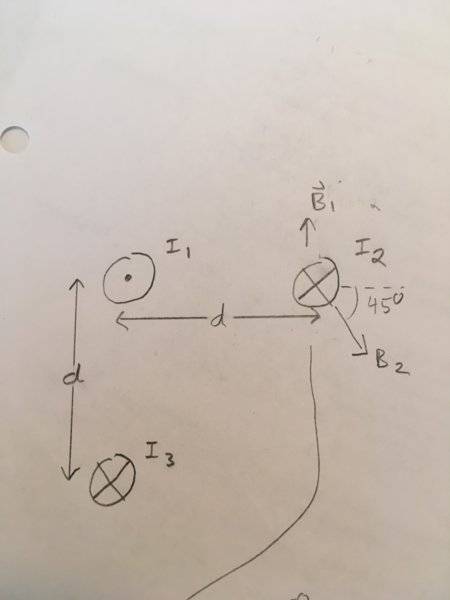

Hello kuruman!
So I was thinking about the magnetic field as (magneticfield.jpg) (Small error in my picture where it says B2 it should say B3)
From there I did the RHR and obtained my forces.
I guess I am still incorrect?
  • Hand-drawn diagram of three long current-carrying wires in cross-section: I1 out of the page at upper left, I2 into the page at upper right, and I3 into the page at lower left. Distance d is marked between I1 and I2 and between I1 and I3. Arrows show field B1 pointing up at I2 and B2 pointing down-right at 45 degrees from I2.
The directions for the magnetic fields are correct as shown in post #3. Now you have to do another right hand rule diagram for the forces.

I guess I am not seeing how my Forces.jpg image is incorrect in post 1. I realize you said that the forces need to be perpendicular to the line adjoining wires, so does that mean into or out of the page since those are both perpendicular to the lines adjoining them?
Sorry, your forces in that diagram are correct. I got confuse with the mislabeled B2 that should have been a B3. You now need to write F3 in component form and add the two forces.

So I am getting the total force acting on wire 2 is:
From here on out F1 on 2= F12
and F3 on 2=F32
Ftotal=F12(i-hat) - F32cos(45°)(i-hat) - F32sin(45°)(j-hat)
After thinking about a bit more:
F=ILxB
F12=I1LB1sin(90)(i-hat)=I1LB(i-hat)
The question is asking for Force per length so
(F12/L)=I1B1(i-hat)
and
F32=I3LxB3sin(90) (-cos(45)-sin(45)) I am saying sin(90) for the cross product because the angle between current I2 and B32 is 90 degrees... Therefore
F32=-I3LB[3(√2)/2](i-hat) - I3LB3[(√2)/2](j-hat)
(F32/L)=-[(√2)/2]I3B3(i-hat)-[(√2)/2]I3B3(j-hat)
(Ftotal/L)=I1B1(i-hat)-[(√2)/2]I3B3(i-hat)-[(√2)/2]I3B3(j-hat)
