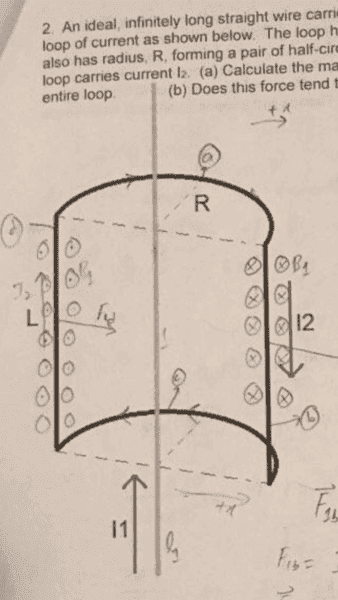

An ideal, infinitely long straight wire carries a current I1 and is partially surrounded by a loop of current as shown below (image attached). The loop has length L, parallel to the infinitely long wire. The loop carries current I2.
A) Calculate the magnitude and direction of the force exerted on the entire loop.
B) Does this force tend to cause rotation of the loop?
Fwire=ILxB= ILBsinθ (The F, L, and B are all vectors, once you do the cross product they are no longer vectors)

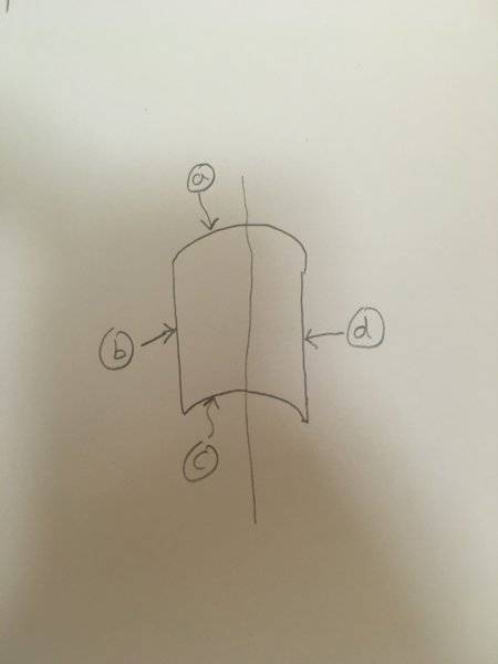

Each wire is creating its own magnetic field at the location of the other wire. I broke the semicircular curved wire into 4 segments, labeled them a-d (segments.jpg).
The magnetic field from the infinitely long wire on segment "a" and "c" of the curved semicircular wire loop is everywhere parallel or anti parallel to the current traveling through those segments. Therefore the force on those wires is zero. The only segments that are affected by the infinitely long wire are segments "b" and "d" of our loop. Segment "b" feels a force towards the center of its circular shape (to the right) and segment "d" feels a force to the right.
Fwire d=I1LxB1=I1LB1(i hat direction)
Fwire b=I1LxB1=I1LB1(i hat direction)

For part a, the givens are I1, I2, not I1, B1.
For part b, what do you think? How does a force on an object cause it to rotate about an axis? What axis do you think they mean?

Yes, that's what I think they want.
cookiemnstr510510 said:
The only thing I can think about rotational motion would be some sort of Torque equation
Right. So what torque do these forces exert about the central axis?
τ=Fwire b(R) + Fwire d (R), R=lever arm. I am stuck here.
R=lever arm
The lever arm is the perpendicular distance from the line of action of the force to the axis, i.e., if you follow the line of action of the force, how much does it miss the axis by at its closest approach?

I feel like the line of action goes directly through the the axis (axis meaning the infinitely long wire)
Right. So how long does that make the lever arm, and what does that tell you about torque?

The lever arms length would be the radius of curvature, R. But there is no component of force that is perpendicular to the lever arm, so it won't rotate?
No. I asked: "if you follow the line of action of the force, how much does it miss the axis by at its closest approach?", and you answered, correctly,
So how much does it miss by?

It misses it by 0?
It misses it by 0?
Right. So what can you say about the torque it exerts about that axis?

That there is no torque about the axis?
Yes!

So since there is no torque about the axis this means that there is no rotation, correct?
From looking at the problem initially my intuition was that since the force was only in one direction how could there be rotation? Does that logic make sense?
Right.
