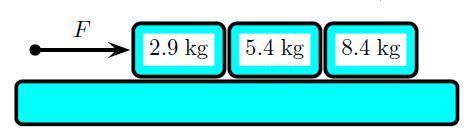

Three blocks are in contact with each other on a frictionless horizontal surface. A 402 N
horizontal force is applied to the block with mass of 2.9 kg as shown in the figure below.
The acceleration of gravity is 9.8 m/s2.
a. What is the net force on the block with mass 2.9 kg? Answer in units of N.
b. What is the resultant force on the block 2 with mass 5.4 kg? Answer in units of N
c. What is the resultant force on the block with mass 8.4 kg? Answer in units of N.
d. What is the magnitude of the force between the block with mass 5.4 kg and 8.4 kg? Answer in units of N.
e. What is the magnitude of the force between the block with mass 2.9 kg and 5.4 kg? Answer in units of N.

  • Diagram of three blocks in a row on a frictionless horizontal surface, labeled 2.9 kg, 5.4 kg and 8.4 kg from left to right, with a force F pointing right into the 2.9 kg block.

Call the acceleration a, then write out good ol' Newton's second law for all three blocks together (that should give you the acceleration), and then write out Newton's second law for each block individually. :wink:

402 = (2.9+5.4+8.4)a
a=24.0719 m/s2
a. F=ma
F =2.9(24.0719)
=69.8084 N
b. F=ma
F= 5.4(24.0719)
=129.988
c. f=ma
F= 8.4 (24.0719)
=202.204

Your F = ma for a. b. and c. is the net force on each block …
so it will be the total of the applied force F (first block only) and the force(s) between the blocks.
Try the right-hand block first. :smile:​

You're doing d, which is the force between the middle block and the right-hand block …
So use F = ma for the right-hand block: a is the acceleration you've already found, and F is the net force, which is just d. :wink:
Now try F = ma for the left-hand block. :smile:

e. I did 129.988 + 202.204 = 332.192 N. This is correct, but I don't know why.
