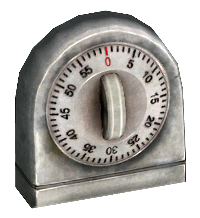

Hey everyone, I need to make or design a simple mechanical time delay. This probably isn't easy since I can't find anything on the market that's small and cheap. Was thinking some wind up toy might work, haven't found the right one yet.
I was thinking maybe small box with a rod coming out of it (but open to ideas). If you push the rod all the way in it should take time for it to come out, maybe 2-5 minutes.
HOPING TO ACHEAVE:
~ Cheap under $3 but hopefully cheaper.
~ Small (hopefully smaller than a pack of cigarettes)
~ Needs to go in fast so no mechanical gearing on the way in.
~ Comes back out very slow 2-5 mins.
~ Needs to be able to push 1lb (maybe less not sure at the moment)
Does anyone have any ideas?
PS even a battery powered one would be ok if cheap. Haven't found anything similar already manufactured still.

Can you sam more about the application? Is the 1lb load on low-friction rollers, or do you need 1lb-f applied through the whole movement of the arm? How far do you need to push the load?

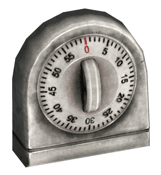

You could start with a basic egg timer and adapt it maybe...
https://vignette4.wikia.nocookie.ne...g_timer.png/revision/latest?cb=20110402182025
