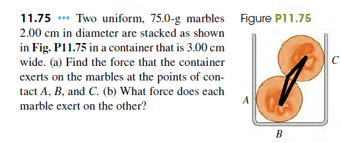

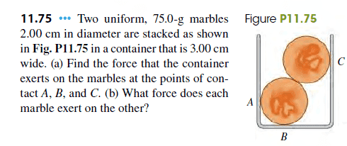

Two uniform, 75.0-g marbles 2.00 cm in diameter are stacked as shown in Fig. P11.75 in a container that is 3.00 cm wide. (a) Find the force that the container exerts on the marbles at the points of contact A, B, and C. (b) What force does each marble exert on the other?

I just cannot figure out the geometry of this problem, at all, which I need to even begin the question. How do I know where the point of contact of the two marbles is?

The points of contact are labeled in the figure as A, B and C. How far do you think A and B are from the bottom left corner of the container? What about point C?

A is 1 cm above, B is 1 cm to the right, and C I don't know. I know that Force B would be equal to 0.075*2*g, and all I can say about force C and force A are that they are equal and opposite to each other

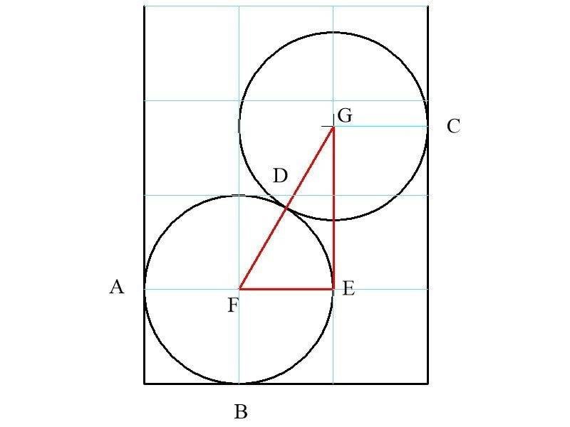

How do you know what the center to center distance is? Clearly the horizontal distance of the centers would be 1, but how do you know the distance from one center to another?

What is the distance from F to D? Hint: Point F is at the center of the circle and point D is on the circumference. How about from D to G? Add the two. (Thanks for the drawing, Nidum)

Why did you draw a straight line between the two centers, isn't it possible to have the two centers not lie on a line through both their radiuses, I'd draw what I mean, but paint won't allow me to, something along these lines

Imagine a plane that is tangent to the two marbles at the point of contact. The line connecting the center of one marble to the point of contact is perpendicular to that plane and so is the line connecting the center of the other marble to the point of contact. Since these two lines are perpendicular to the same plane, they must be parallel; since they pass though the same point (the point of contact) they form a straight line between the two centers, just like Nidum drew. Your drawing shows two line segments that do not go through the point of contact and are not a straight line from one center to the other. The center to center straight line must go through the point of contact.

I see, that makes perfect sense thanks for the explanation. Okay, so now I form the triangle with horizontal 1 and hypotenuse 2, solving for the height gives me √(22 - 12 = √3. So a total vertical distance of √3 + 1. So the torque on the system from point C woould be Fc * (√3 + 1).
So i get that Fa = Fc*(√3 + 1), I must have done something wrong since I previously got Fa = Fc when I balance the forces in the x direction.
It is still true that FA = FC. The contradiction arises because you forgot the torque generated by the weight of the top marble. Also, use symbols instead of a mix of symbols and numbers. If you use 1 for the radius, you might get in trouble when you plug into find numerical values. Use R for radius, then plug in at the very end. When you eventually find the forces they should be a number times mg, the weight of one marble.

Right, okay, so the center of gravity in between the two balls should be at a horizontal distance of 1.5 from the corner, which is 0.5 from point B, so the torque due to grabity would be 0.5*0.15g, so in the end we have 0.075g + Fa = (√3 + 1)Fa, which gives me 0.075g = √3Fa, and in the end, We get Fa = 0.42N = Fc. And Fb = 1.4715.
b) For the force of each marble on the other, we have that for the forces in the x direction of the bottom marble, Fm * cosθ = Fa
From the triangle we formed before, cosθ would be 1/2, so we get Fm = Fa*2 = 0.84N.
Is that right?
That's right.
