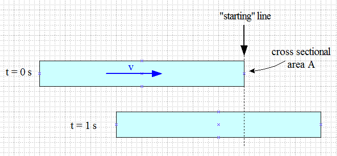

Make yourself a drawing. Imagine a tube of water with your given cross sectional area moving at velocity v. Find the amount of water that moves past a given "starting line" in one second:

So would that just be the cross-sectional area multiplied by 3.5 since the velocity is 3.5 metres per second? Giving a value of 0.1575m^3
Don't forget to include the time (1 s). It's important to make the units come out right. You should always check that the units come out right!
How are you going to convert that volume of water to a mass value?

Nope. Distance is velocity x time. The length of the tube of water passing by is d = vt.

You're not dividing by time here. The velocity of the flow is 3.5 m/s. The flow rate Q = A × v, and you know A and v.

You should be. It's the standard equation of continuity. It's used all the time in pipe flow and such.
The mass flow rate is a modified form: ##\dot{m} = ρ A v##

I think writing that out gave me a brainwave..would you multiply the volume by the density, giving an answer of 162.2kg?

The quantity A ⋅ v is the volumetric flow rate, in cubic meters per second.
Multiplying the volumetric flow rate by the density of the fluid in kg / m3 gives the mass flow rate.
