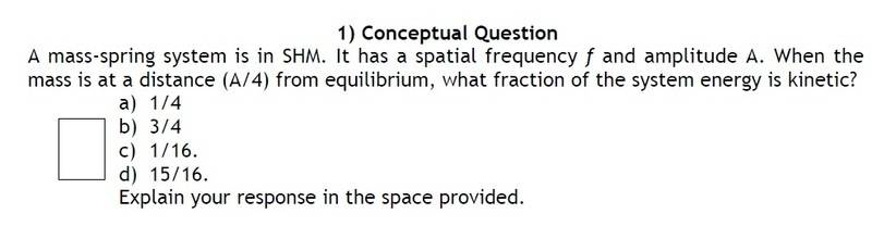

Well since spring is in SHM, only conservative forces are at play here. So using conservation of energy, the kinetic energy would be the change in potential energy. Which I have set up as
KE = 1/2k(A^2)2 - 1/2k(A/4)2
after some algebra, combining like terms with common denominators I am left with,
KE = (15/32)kA2
now when I take the fraction of the two, PE/KE of
(15/32)kA2 / 1/2mv2
I get (15/16)kA2/mvf2
So I'm thinking my answer would be 15/16
I don't know whether to just ignore the variables since there was no value in them or I find a way to relate them since I was given a frequency?

Sorry but I'm not following you there. :rolleyes:
What's the total energy of the system? Once you find that you can find the ratio of kinetic energy over total energy.
It might be 15/16. But if so, you haven't quite shown why yet.
Hint: your next step is to find the total energy of the system.
[Edit: Another hint: the total energy of the system is conserved, and doesn't change with time. :wink:]
The reason this is a "conceptual" problem, as opposed to a "calculation" problem is that you can use the fact that the potential energy of a spring is proportional to the extension or compression of the spring to quickly find the ratio. When the mass is at distance A from the equilibrium all of the energy is potential, when it is distance 0 from equilibrium, none of it is. when it is at distance A/4 from equilbrium (and so 3A/4 from greatest extension) what fraction of the energy is potential energy? What fraction is kinetic?
Oh I think I've figured it out. The total energy of the system can either be when x is at it's max "A", or when the velocity is at it's max = v_max. So I need an equation for the kinetic energy, which I set up as
1/2mvf^2 = 1/2kA^2, which gives me the Vfinal I can use to substitute into the kinetic energy equation above which allows me to take the ratio, and everything being canceled out I am just left with 15/16

I think you mean the potential energy is proportional to the square of the extension or compression. :smile:
I am not familiar with whatever you are doing with the "1/2mvf^2." :rolleyes: Maybe you mean [itex]\frac{1}{2}m(v_{max})^2?[/itex].
But yes, the potential energy of the system is [itex]\frac{1}{2}kA^2[/itex] when the extension is equal to A. You can use that (and a hints from HallsofIvy and myself [my previous post]) to determine the total energy of the system. :wink:
In other words, you could solve for [itex]v_{max}[/itex] and substitute things around. But it's not necessary to even bring [itex]v_{max}[/itex] into the problem. If you know what the potential energy is at maximum extension, then you also know the total system energy.
